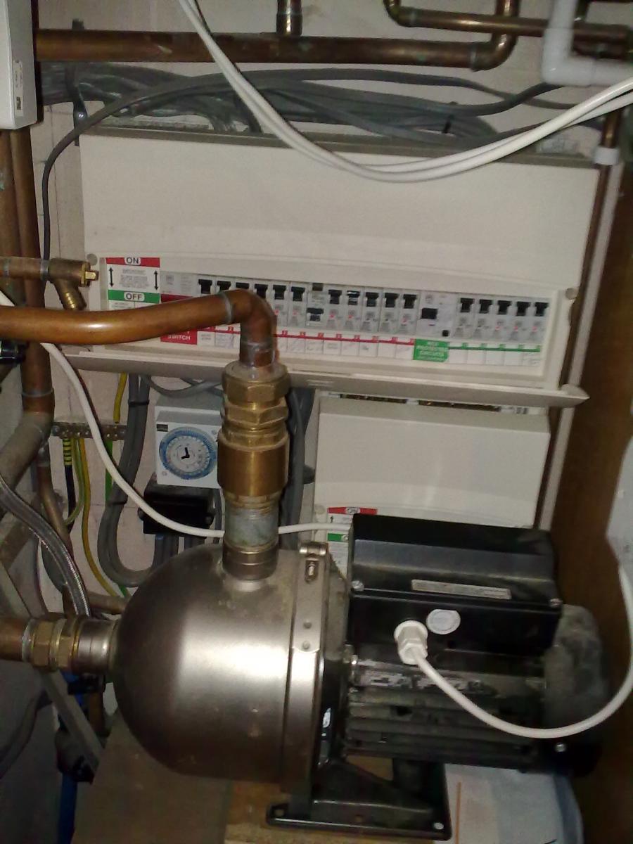

This is a good example of how NOT to do it (and no it wasn't me!!!!!!!)
I was having a nosey around the showhouse on a new-build estate here recently, & noticed the CU was mounted in the entrance hall with the top against the ceiling & one end right against the top corner of the window frame thus preventing the fitting of a curtain rail & obscuring that part of the window !!!
When I questioned this with the sales lady who was showing me around her reply was "Well, this is just the showhouse" !!!
The mind boggles !!!
