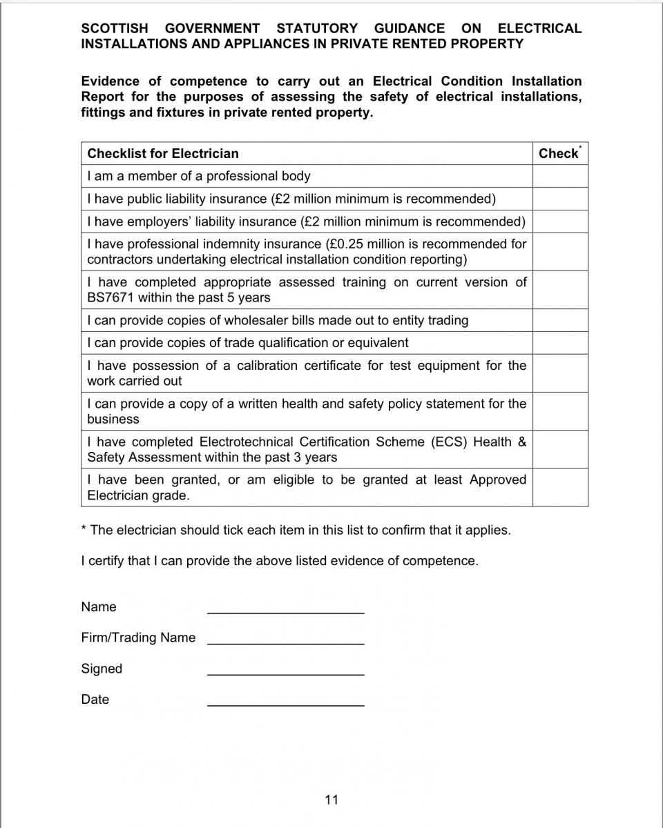

The requirement is to 'meet the standards of' NICEIC / SELECT.
If a contractor can prove they meet the standards then a landlord can use them- it's up to the landlord / letting agent ordering the work.
There is no mandatory requirement to use SELECT / NICIEC, but there is a requirement to use someone that can prove competence - thus promoting the possibility of higher standards.

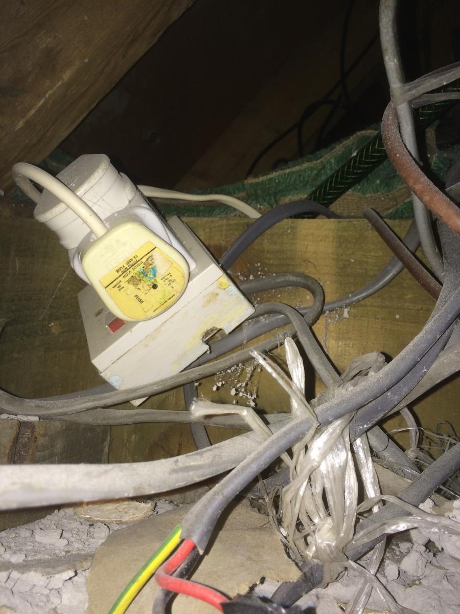

I have loads of photos of what these cowboys do - this is a recent bag-o-****e I found above a kitchen ceiling:
This also stops the Dangerous Dave's and Rodger the Bodger's that do drive by EICR's or can't I&T because they can't hold a pencil due to dragging their knuckles along the ground.

Quite the opposite- SELECT were instrumental in lobbying to prevent Part P in Scotland with the previous Lib/Lab coalition in Scotland pre 2007
See the check list
