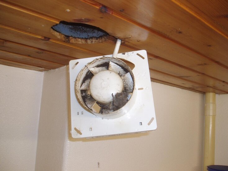

Yea they also try and use an extract fan as a exercise wheel
Reactions: 2 people
