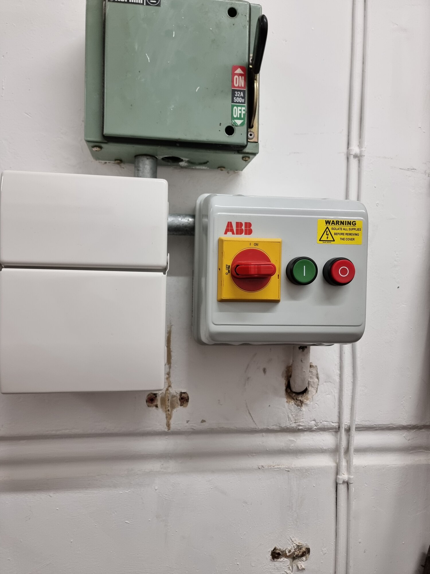

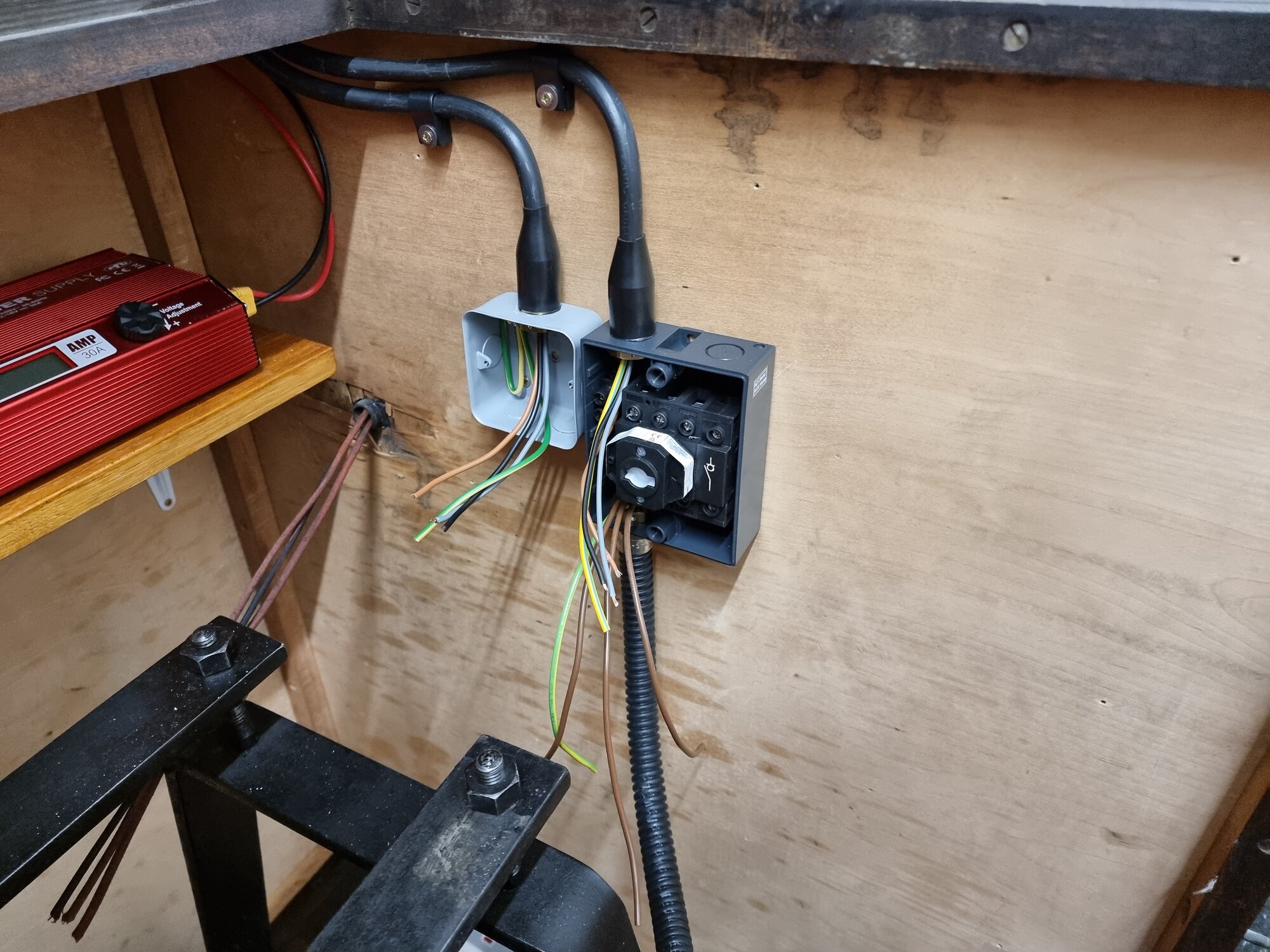

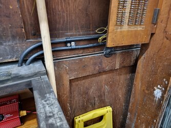

Dave and I popped down to Regent St. yesterday afternoon to first-fix this. We opted for 4c 1.5 SWA from the starter, an additional isolator next to the motor, and tri-rated in 20mm Adaptaflex SP to the motor. The FCU for the 18V DC PSU is run in 3c 2.5 SWA.
Strictly speaking we didn't finish the first fix as we were let down by a couple of rogue 25mm couplers with incomplete threads. Parking anywhere nearby is impossible, even stopping to drop off is a challenge, so we went on foot and didn't have all the spare bits that would normally be in the van. It seemed a waste of time on a Friday afternoon to walk down to Berners St. just for conduit couplers, so I'll take some on Monday.
With the larger installations and where blowers are hidden away many floors below, etc, I tend to spec custom star-delta or soft starters often with symmetry monitoring relays, electronic overloads and ELV controls. But here there is just one control point adjacent, the blower is small and in-the-room, therefore I went with an off-the-shelf DOL unit by ABB with 230V control, adding a DP contactor for the 230V PSU.
