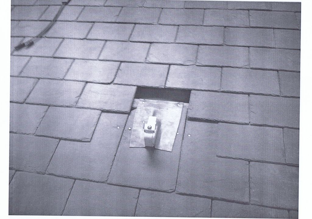

The boys at work (also posted elsewhere!) http://bit.ly/SlateRoofInstall , Anyone at Segen in Sept I'll be at the bar, thirsty :)
@alexpau
Paul, many thanks for the photo's , that's a neat and tidy installation (although it looks like someone's practice / training roof rather than a real world situation:) ) , however I'd be really interested in your interpretation as to whether the photo you sent is Eurocode 5 compliant and how you interpret that. Thx

Hilti do the 'normal' slate bracket for those tiles although you will still have the problem of trying to remove the slates as carefully as possible and then replacing with lead flashing is the easiest solution so I believe. The brackets do have a thickness so can still push up the slates if they are not cut in between them Slate Tile 3.jpg

Hi Worcester. All Hilti rail mounting products are Eurocode compliant including the roof screws ( i believe we are the only manufacturer who have roof screws supplied with our mounting systems which are). The issue is if the screws i.e. 8mm or 6mm comply with building regulations as most european roofs are boarded and dont use rafters and battens like we do in the UK. If the roof timbers allow the use of 8mm or 6mm screws them our products comply. The issue is for example if the roof timber is 80mm wide then if you drill into the centre of the timber ie 40mm then the diameter of the drilled hole cannot be bigger than 10mm to comply with building regs this is partly the problem in why you cannot use hanger bolts for fixing slates as they will not allow for compliance with building regs in UK roof timbers.

Hi Paul, thanks for that so if a rafter has to be 80mm wide before you can install an 8mm hanger bolt, which Hilti products installed in which manner are Eurocode 5 compliant on a standard UK 35mm wide rafter?
i.e What do you have and how do I fit it to a 35mm wide rafter and comply with Eurocode 5?

Worcester HIlti have just launched a 6mm diameter holed roof hook ( in pantile initially) which has three rows of 6mm holes along with 6mm screws which comply with Eurocde and GB codes along with the 6mm screws again which have been tested and approved and come as part of our 10 yr system warranty. As i mentioned before a potential problem within the industry is not just if the mounting kit is approved its also the roof screws used to tighten down the roof hooks, if for example you purchase your mounting kit from a supplier and you get your roof screws form somewhere else what happens if the screws of system fail i.e. the screws corrode or the system break under load who do you go back to? the chances are the mounting kit manufacturer will not except liability, Hilti are the biggest construciton fixing company in the world and we system sell ( not part systems) so we warrantee the entire system as long as its installed to manufacturers specification for 10 yrs under our company insurance.

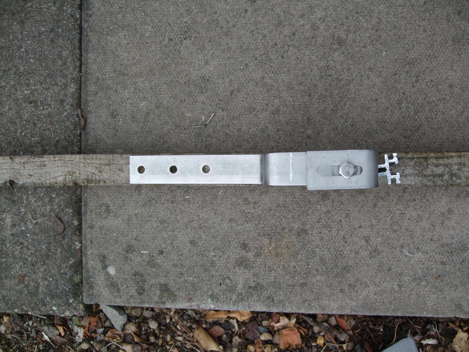

As most people here know hanger bolts etc are my 'bete noir', Could you please forward the approvals to me, I actually have one of the hooks that you talk about, even posted a pic of it on here not long ago:
DSCF4366.jpg and here's the azur one : DSCF4367.jpg both on a 35mm piece of tanalized timber.
Base on the Eurocode rule of 4 x diameter from edge, how does the 6mm x (4+1+4) = 54mm still work on the 38mm rafter?
Also as it is staggered, it won't be even 4 x . Eurocode 5 table 8.6 attached:
Or Am I missing somethong here?
I'd really like to see a copy of those approvals, then you'll get my full endorsement. You have my email address.

All this makes sense and and fixing to an under slate would be the correct thing to do, when fixing to a rafter or batten you may or may not need extra timber it really depends on the width of the timber to comply with Eurocode and Buiding regs. On 35mm - 38mm timber battens you should only be using stainless steel 6mm screws which have been approved for use with Solar PV systems.

I apologise alexpau as I have not made my self clear. For me having a slate between an anchor and a rafter is not acceptable as in this instance slate would not be a good packing material. All the slates have to come off, the anchor securley fixed to the rafter and then the slates replaced, cut around the anchor as necessary and a lead flashing fitted. The point I was making was the best place for the anchor is face to face with the rafter but this requires an alteration to either the battens or the rafter if everything is to sit flat again afterwards. If you ease up the batten and insert the anchor under, it will force the batten upwards thus arching the local slates upon completion. Sorry - I hope this is clearer.
