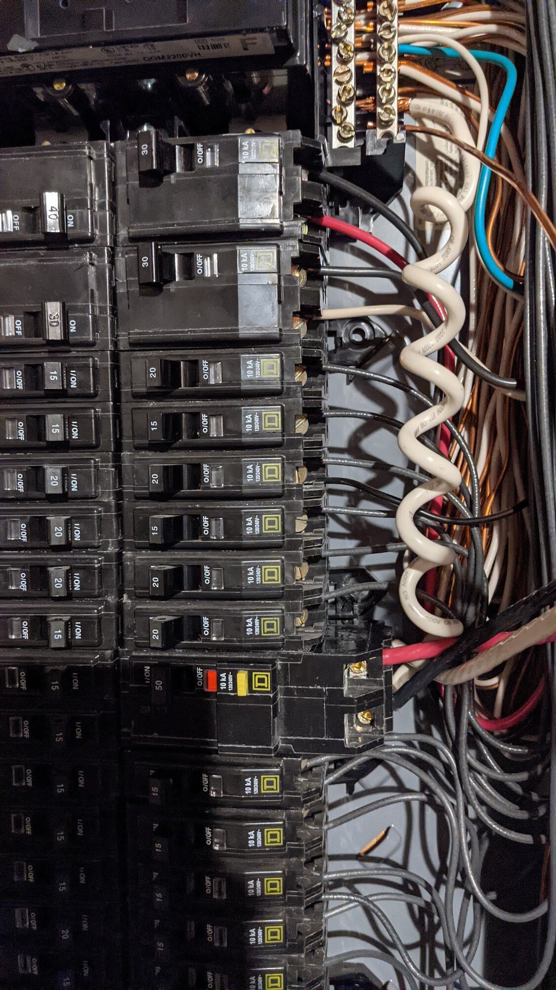

OK, so I was lucky enough to get a refund on the used 8# wire and 40 amp breaker. Fished in a new 6# with a Square D QO250GFICP QO 50-Amp Two-Pole GFCI Breaker. Now, it's tripping immediately when I connect the appliance. Here's what I know/can offer:
  • Breaker on, nothing connected - breaker remains on - trips when pressing test button. (does this indicate the breaker itself is fine?)
  • Breaker on, connect steam generator, trips in less than a second.
  • Pulled ground wire off ground bar in panel, everything works fine.
  • Wire run is 50 feet
  • Using a 5 foot rubber 50amp cord with 50amp rated outlet
I did some reading and it seems that when it works after pulling ground wire, it's possible there's a "differential with the ground". But I'm not sure what that means. I certainly don't want to run it without the ground.
Any tips on how to troubleshoot?

I just read an older forum where someone was having similar issues and it turned out that the GFCI breaker didn't like being in the main panel with a lengthy wire running to the end point device. In other words, they moved the GFCI device closer to the appliance, within a few feet. I can't help but wonder if I should move the breaker to the appliance end of the wire run and put it in a sub panel? Thoughts?

First off the neutral in your cable has to terminate on the breaker itself and the squiggle wire from the breaker hooks to the neutral bar. Yes when you press the test button it’s supposed to trip. Your GFCI breaker doesn’t trip because your cable is too long.
Yep, I should've mentioned that I'm seasoned enough to know how to wire up the common, but completely understand your asking - very common mistake with homeowners. So to reiterate, wire comes in to panel, ground goes to neutral bar, the red and black go to load terminals, the white goes to "N" on breaker and the white "squiggly" wire goes to same bar as ground. Pic attached.
