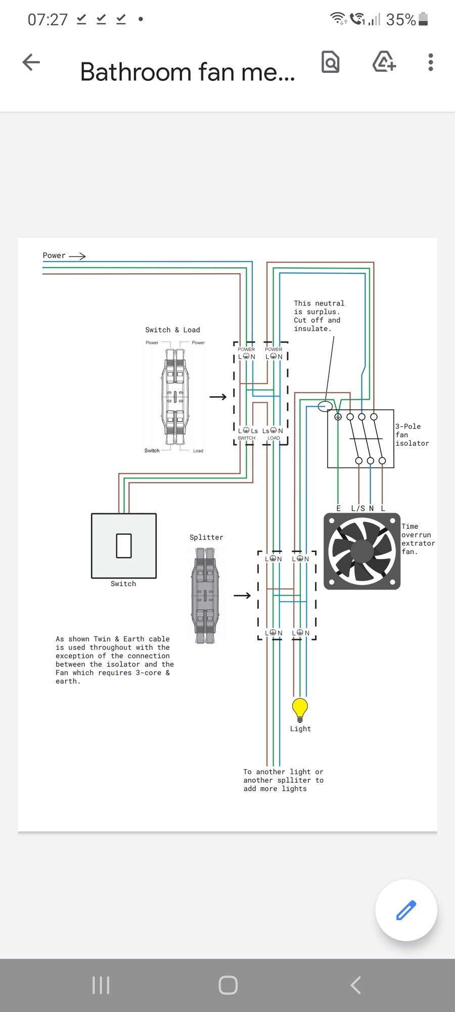

Simple replacement of an old noisy fan. Should have been rip the old one out, put the new one in. Only change is the new fan has a timer overrun which was chosen due to the old tenants leaving it in for so long it eventually went bust. The old fan didn't have a timer.
Anyway... I've got the new fan and isolator in place, went to replace the twin core with 3 core... and that is when I found the rose was replaced with Quickwire a few years ago. I've been given a few (bit Heath Robinson) solutions of sorts on one forum, which if it wasn't in a Part P location would be fine, but mmmm not sure about bathrooms. And on another electrician forum on Reddit, I only got sarcastic comments back, and one solution that would definitely fail inspection. So third time lucky.

Not quite; it goes: feed from previous luminaire ... Quickwire splitter (which has of course three exits: one to light switch, one to the bathroom light, and one to the previous shower (which had no timer, so was simply twin core through to the fan. Just to clarify there wasn't even an isolator... The original installation must go back at least thirty years so that may have been fine then, but now it wouldn't be - so I have put an isolator in.
So... From the NEW (timer overrun setting) fan going back to the Quickwire, it now goes "Fan... 3 core to fan isolator... 3 core to ... Er... What the ?!?!???!". (I am looking at my left hand that is holding 3 core, in my right hand I am holding a Quickwire splitter).

It sounds like a white Quickwire, with feed in, feed out, switch wire, and light fitting.
From the above text, feed in came from previous light, and feed out went to fan (he said shower).
Switch wire must be light switch, and the switched output must be the light fitting (bathroom light).
So it's the switched live he's missing and needs the 1-core for. Not the Permanent Live.

This just needs a T+E from loop out to the isolator and a 1 core for switched live.
In my install the loop out went to the next light hence the need for an extra grey multi-way quickwire...

All sorted, thanks to Quickwire who provided a diagram for this exact scenario in a Part P location. If you're registered with ECA, NICEIC and/or ELECSA, this is their Approved Method.

Interesting. Funnily enough their solution is basically the same idea.
I was advocating a 1 core + Earth from light fitting to isolator.
Their solution is using another quickwire splitter on the load side and running a 2 core T+E to isolator, then cutting the one that isn't needed, basically making it a 1-core + Earth again!
That said their solution has some benefits:
-It's probably cheaper to get the quickwire splitter and use T+E that you probably already have rather than acquiring a reel of rarely needed 1 core and earth .
-their solution has the advantage that if you can't get another cable into the light fitting the joint can be external.
-it allows more fun playing with another quickwire!
As a note to anyone else finding this thread in future, both their way and my way has an extra gotcha if the light fitting isn't the last one on the circuit. It's probably easiest to journey to wago-land then, or do it as per my original answer in this thread.
