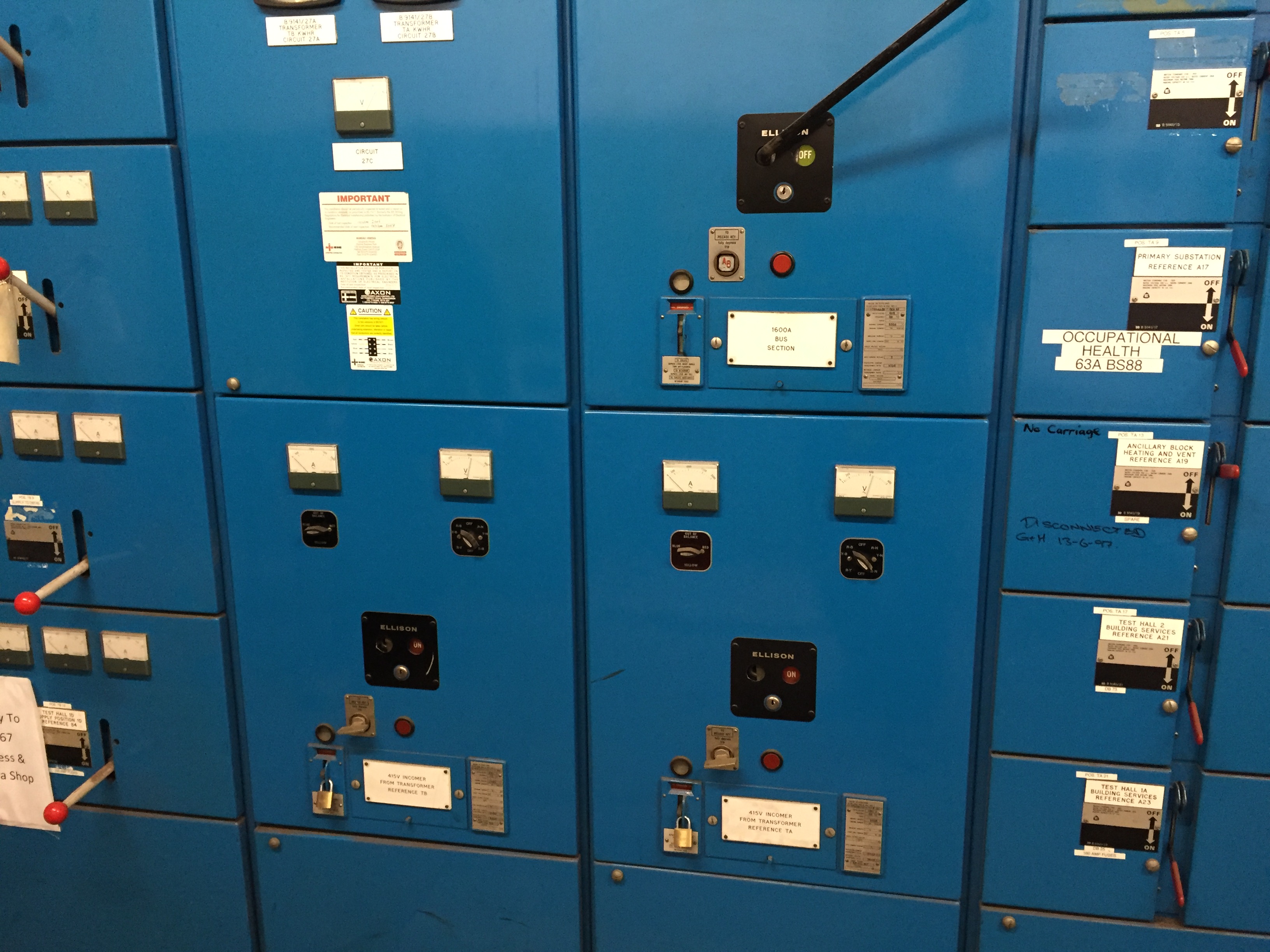

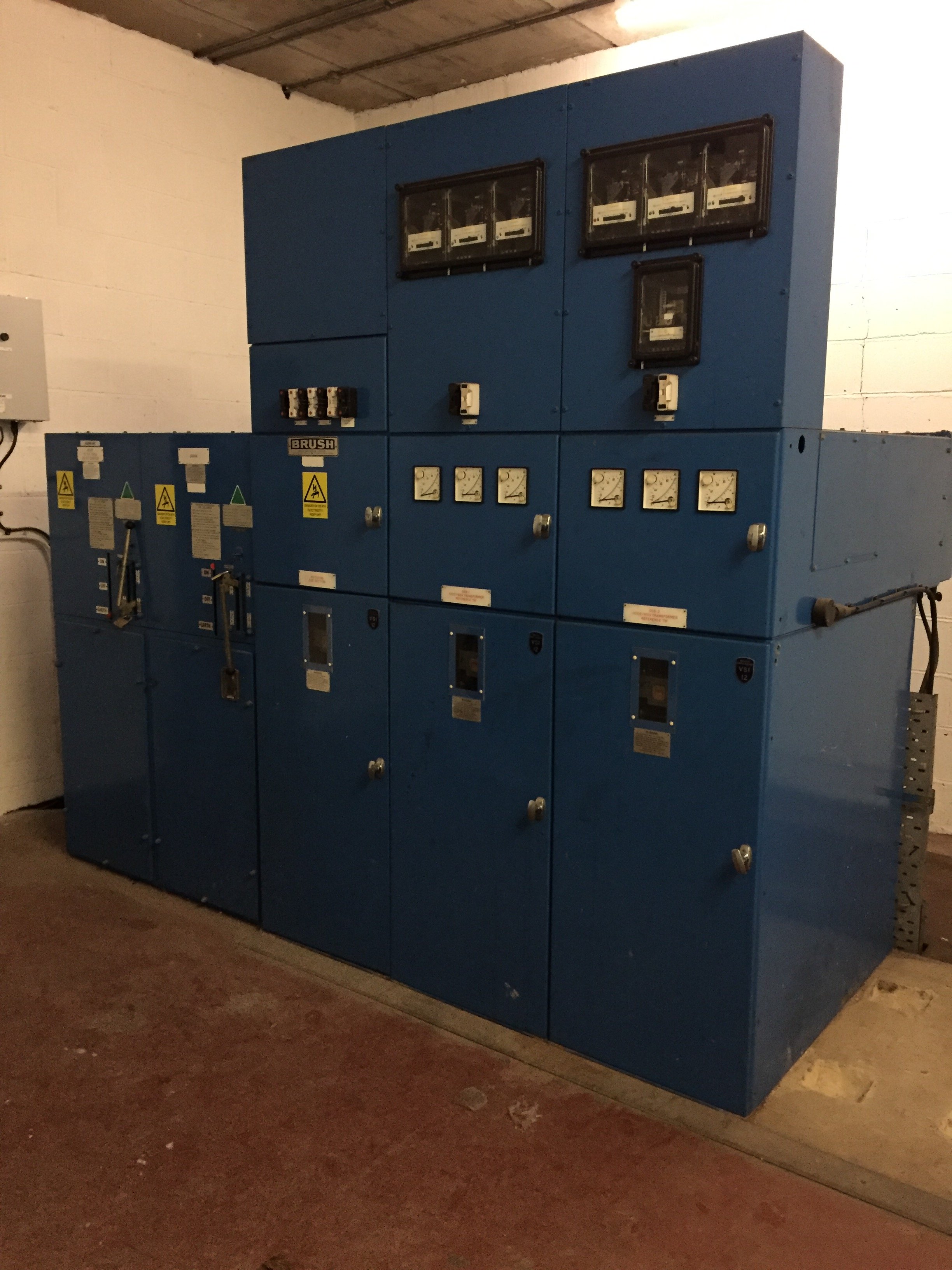

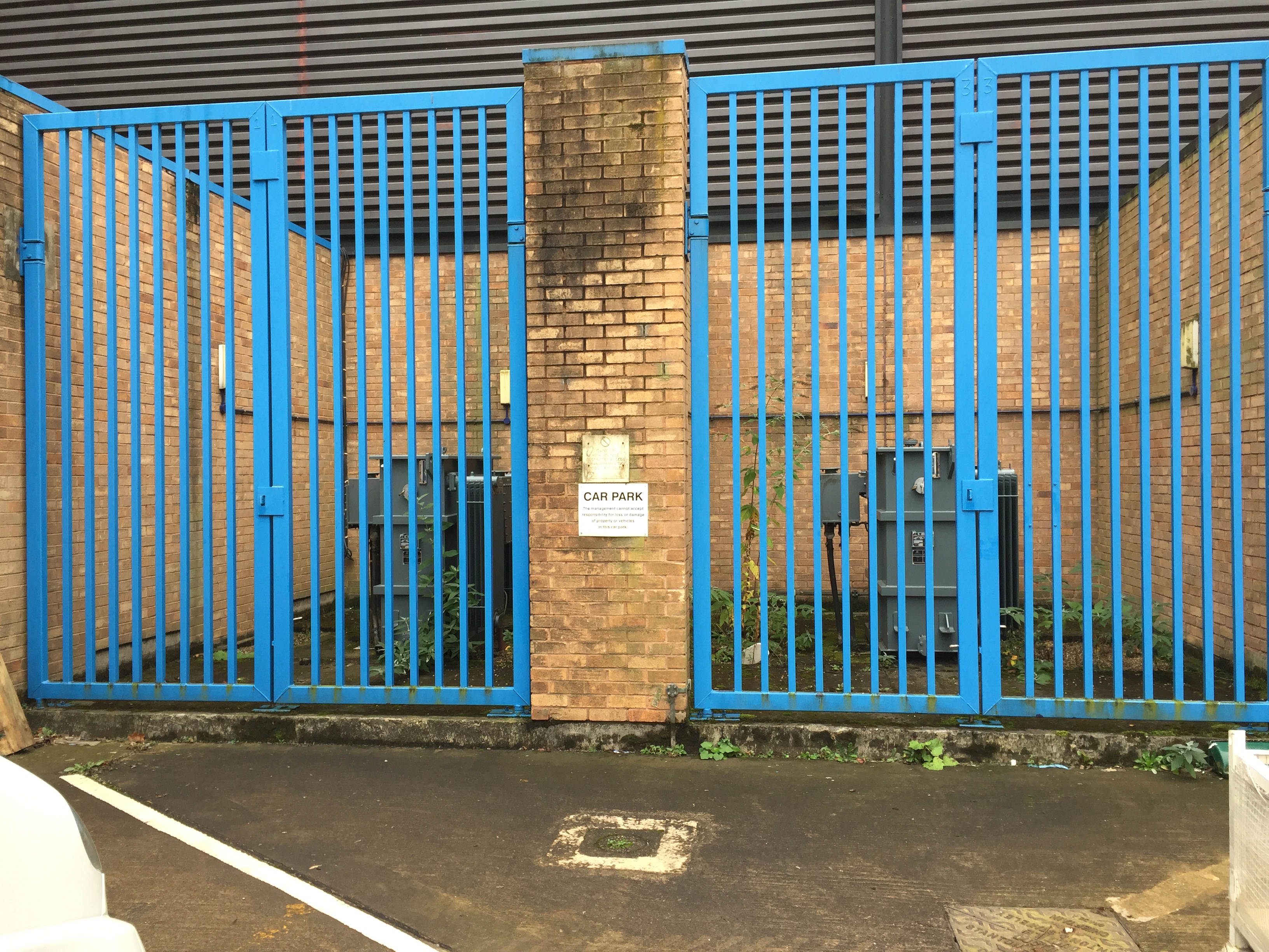

Here are a few photos to give the story a bit more depth, There is the Beautiful Ellison LV Panel that we deal with and also the 2 x tx and the HV Gear.
I managed to get the time curves for the LV panel last month Because we need to service it soon and get the oil sorted which is not the easiest to get hold of for the pots for these things, luckily i managed to find a really helpful 70 year Ellison specialist who had been dealing with them for 50 years.
It may seem sad to some but I love these old beauties, She is a Lady!!
