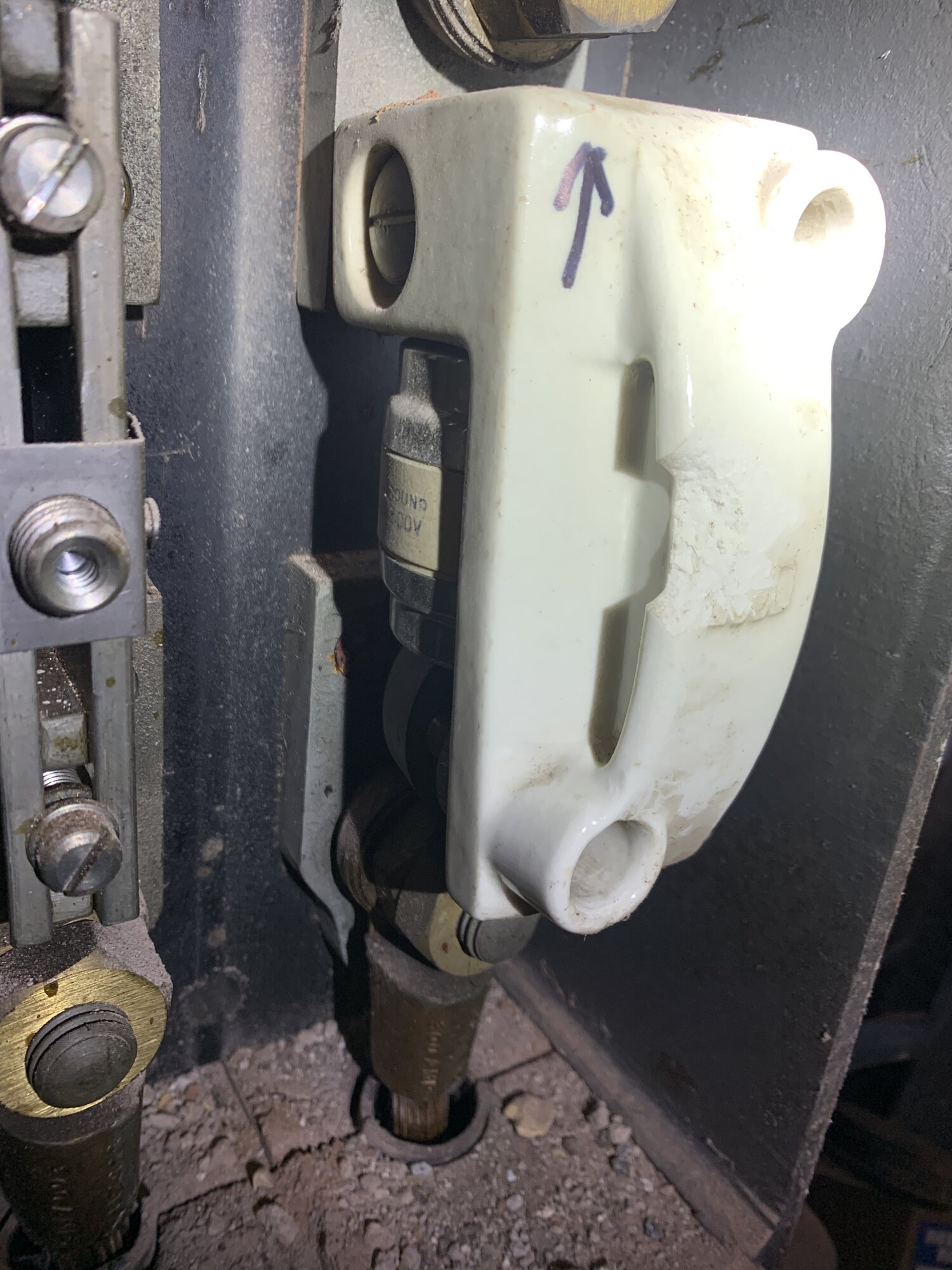

Afternoon all. Does anyone know how to remove this fuse. !!! We’ve pulled it, undone the screws But it’s not budging. , it seems like there’s something mechanical holding it in place ???

Are there screws in the holes top right and bottom left? could be fixing the carrier to the bare,
I suspect it is just tight (by design, and by age) but especially with old stuff you really can't tell what is a sane force to attempt and what will break something. If live, that gets nasty real quick.
Difficult to tell from the video, but the screws inside the ceramic holder don't seem to move with the holder, perhaps they just need undoing.
If you've undone the clamps it should slide out. It might have welded, doesn't look like you are pulling very hard. But is it live? I don't think we can tell from the video.
Undo the screws in the fuse holder, they are wedge fuses, looks like a metal clad cut out, which should not be worked on live. You should NOT be messing with it, naughty naughty!
Thats a wedge type fuse. Do not mess about with it live. If it is dead it is some times possible with the screws loose to put a screw driver in and tap the wedge back to loosen it.
