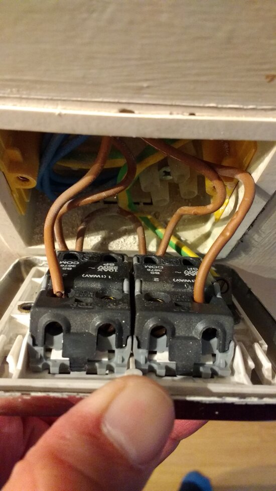

I'm trying to replace this light switch 1 with light switch 2. But the setup is totally differentas you can see and I can't work out what wire goes where.
Any help?
Light switch 1 has a dodgy button loose switch so needs replacing but I can't find a switch plate which matches the existing one.
Old broken switch 1 with wiring still attached
2nd pic is the new switch I'm trying to fit
Any help is much appreciated

You simply have a common feed in and out and two switched lives , it really doesn’t get any simpler
do it 1 at a time. 2 L wires into each of the 2 C (com) terminals. link com1 to com2. then the 2 remaining (switched L) wires into each L1 on each switch.
Thanks for your help guys, particularly Telectrix cos I followed your instructions word for word and I know have a very snug looking perfectly formed light switch.
Result below
