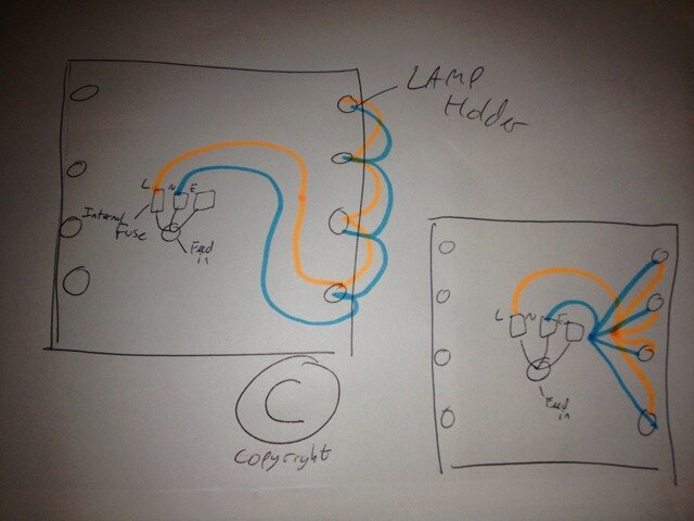

Does anyone have a diagram for a typical 600x600 4 lamp modular fitting and how this is best modified to take LED lamps.
For a ballast fitting it seems usual that two lamps are paired using 1 ballast and a choke and then a capacitor is common to all.
Obviously the ballast is bypassed and the choke is removed for each pair of lamps, but I would just like to see a good wiring diagram showing how conversion is made most effectively.
Thank you

Ill draw a quick diagram if how to wire them and post it up, they are not difficult to wire. What brand of leds are you using out of curiosity?

rip out the control gear feed the led tubes from the luminaire terminal block ( the led tubes are fed from one end only ) L.N. to each tube , you can leave the control gear in and it will work but increases the load i.e consumption so best take it out
Here is my amazing wiring diagram drawn on the back if an envelope.
Orange is live (no brown highlighter)
There are 2 ways to wire them depending on how easy the old cables come out of the lampholders. cutting them short leaves live ends so if they dont pull out link it to the next lampholder or take it to a 5way push connector and join it with the others
And remember to put the tubes in the right way round as only one end is connected to the control gear, it wont do any damage if they go in the wrong way, it just wont work. When fault finding, check this first.

Thanks for your comments - I don't think my initial e-mail could have been too clear as I was after a wiring diagram of a typical modular fitting as supplied and how it is simply modified. I know the how to rip all the wiring and supply line and neutral across the appropriate pins but this is quite time consuming.
