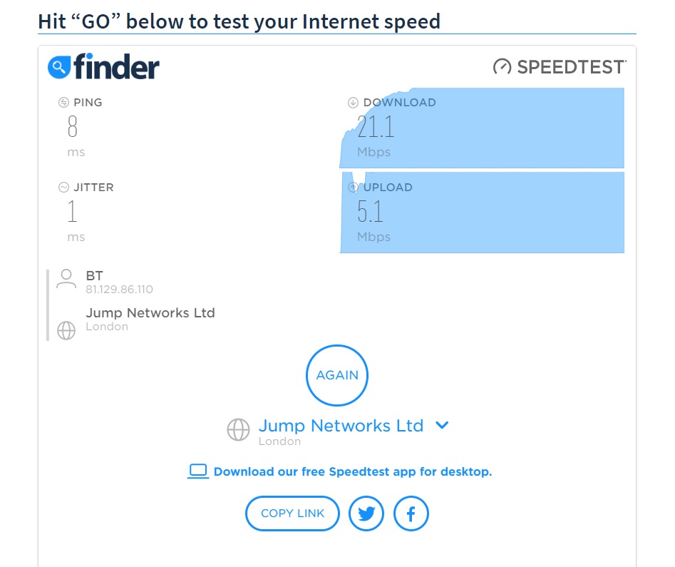

Yeah how long they been telling us that for, my download speed is still 20mbps (FTTP) and I can see the fibre cabinet from my window ! Cat5e can handle upto 1Gb, what more does anyone need !

I'm quite lucky here, being a 10 minute walk from the exchange.
View: https://Upload the image directly to the thread.com/a/3Mk6lAh
Wow I can only dream, is that FTTP? heres mine.......

View: https://Upload the image directly to the thread.com/a/jnzxTQi
I do have a better ping thou lol, sometimes its as low as 1ms
