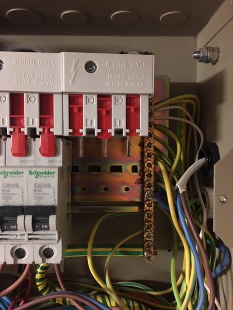

Pricing a job in a school and to get some RCBOs for this board below
My wholesaler say that the new schneider acti 9 isobar p rcbo wont fit this older style Merlin Gerin baord. Anyone had any dealings with this?
I personally think it will fit.....
I don't think the P type fit as they are designed for an integral neutral bar connection I think. A standard Acti9 should fit though.
I tried a standard one but dont fit as the busbar on the DB is on the top

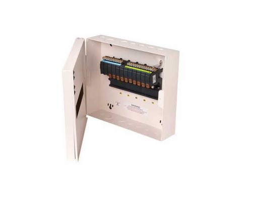

A standard acti9 single phase board has the busbar connection at the top.
Schneider-Electric-SEA9AN10-Single-Phase-10-Way-Type-A-Acti-9-Distribution-Board-1.jpg

Schneider C60 range are Merlin Gerin rebadged. Schneider iC60 range are purely a Schneider design and will not fit.
If in doubt then contact schneider technical support, they have a good team to answer these simple questions on their part, but i can only assume your wholesaler has done this themselves to give such a response in the first place.
