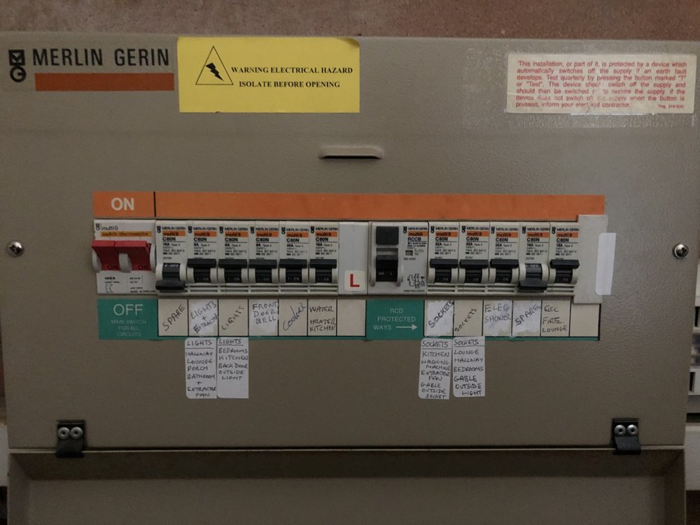

Ok guys following your advice with sourcing used or new old stock and a chat with a retired Electrician, I have decided to have the CU converted to a double RCD unit. This is bearing in mind that the initial EICR recommended having the lighting put on an RCD circuit too.
We have found this RCCB on eBay, see photo, and have a photo of the CU with cover off. However, I have noticed that they look different despite the fact that the serial/product numbers on the RCCB's are the exact same. I cannot find another one like this and also there is a strange, non-switched, unit to the left of the RCCB with a L sticker on it. Is this a part of the RCCB or some other kind of device?
Thanks...
You can't convert these boards to dual RCD.
The busbar is factory fitted in the plastic casing and not accessible for future alterations. There is a gap in it where the RCD fits.
The live terminal block to the left of the RCD takes the live from the busbar to the bottom of the RCD, the RCD outgoing side connects directly to the second half of the busbar.

Rather than faffing with trying to alter your existing CU a better option would be to swap the entire CU, a bit more expensive, but far better in the grand scheme of things, good luck
Swapping the CU will be cheaper than doing what is necessary to add rcd protection to all circuits on this one.
However a new CU will be much lower quality than the existing MG unit, even the new MG boards aren't as good as those ones.
Thank you Davesparks. An excellent explanation of why it can't be done.

I will leave it as it is and leave the rewire and new CU to the possible new owner. Thanks for the good info.

My opinion is that the best thing would be to replace the mcbs with RCBO's.
If it was my house I'd be digging through our stores to find the RCBO's to do the job, I'm pretty sure I'd find everything needed in there somewhere.

If it were my house, I'd be perfectly happy to leave the electrical installation as it is, apart from either a like-for-like replacement of the faulty shower or a simple thermostatic mixer if the hot water system supports it, and consider whether the money saved would be more usefully spent on other things that could provide a greater reduction in risk, e.g. a shower mat, fire alarm system, a washing machine and tumble dryer that won't support a fire, a car with better NCAP rating, a non-slip path, a new house, etc.
