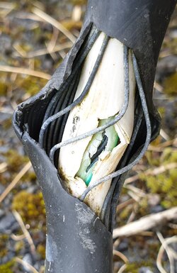

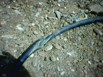

No, it is a real issue!
What do you mean
But how are you gonna damage it in normal circumstances, it's SWA.
No fault is normal circumstances!
It isn't normal to drive a nail into a cable - but you will find loads of instances of "I was putting up a shelf and... or I was just putting this picture up and..."
Cable damage occurs -a lot!
Are examples of swa damage.
Faults happen, you need to protect against damage to the installation in the event it happens.
What do you mean
Im not saying these faults don't happen i'm asking about OP claiming the client was 'lucky' because the cable 'could pull 80a' because there's an 80a main fuse. I'm just talking about the installation as it is now not under a situation where it may develop a fault.
