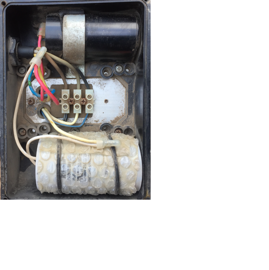

Just checked the capacitors. The white one is on spec 80 microfarads (spec 80 microfarads) but the black one is 184-187 microfarads which is outside the stated parameters 145-174 microfarads
Start capacitors can have wide tolerance, that difference in value should not be a problem. Faulty caps are usually either open circuit or short circuit. The fact your motor does nothing points elsewhere. I'll reply in full later if I can
I see what looks like a 5-core cable entering the motor - brown/black/grey/blue/earth. Obviously this is more conductors than needed simply to operate a motor in one direction and speed, so:
  • Please can you confirm there is no other control functionality from the control box?
  • Can you confirm the functions of the cores at the other end, so that we know where to expect continuity at the motor end?
  • Can you post a pic and/or a sketch that clearly shows the connections to both capacitors?
With this info, we should then be able to make reasonable inferences about what resistances to expect across which motor terminals. It may be that the NVR coil is energised through a thermal cutout in the motor which would explain at least the 4th core of the cable.

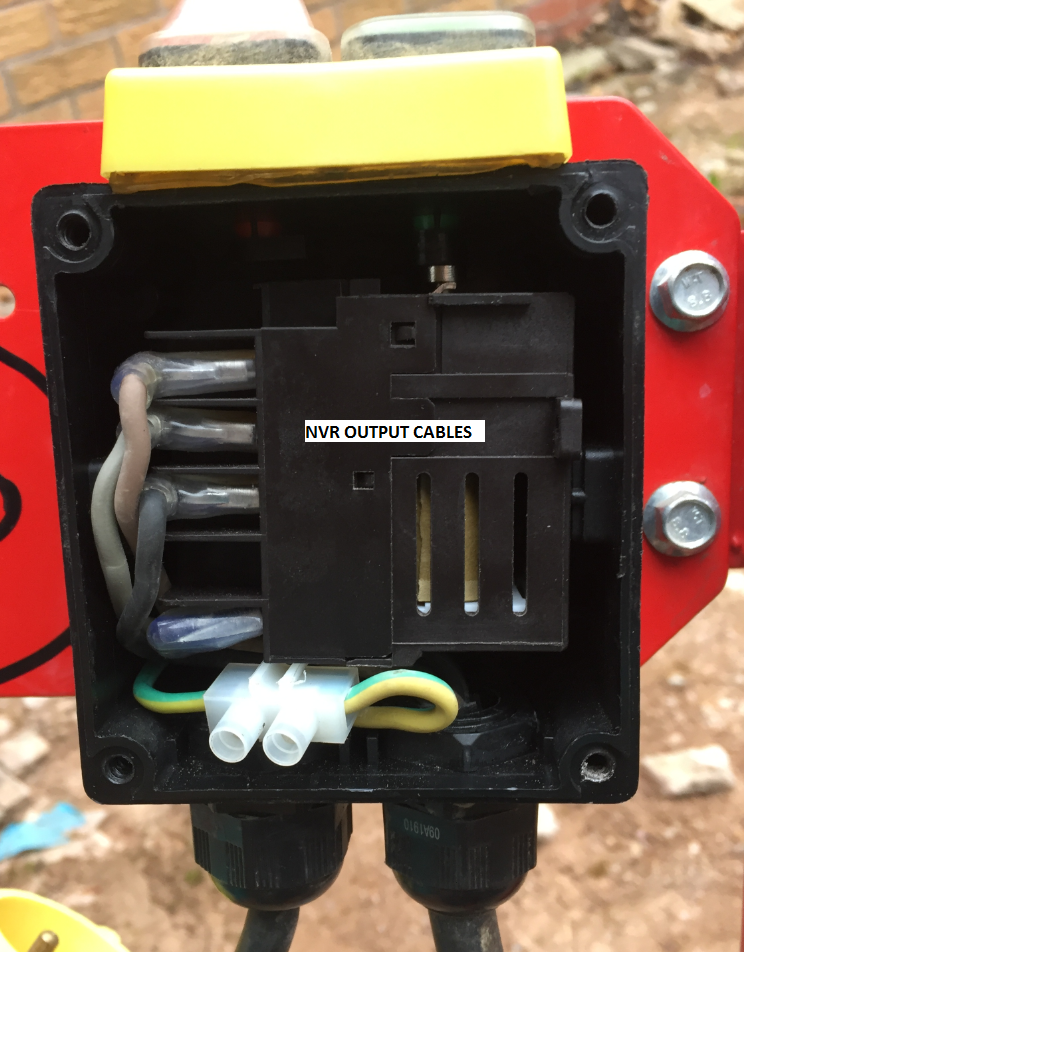

I have attached some more images
OK right, so the cable from the NVR seems to be 4-core. If we number the three white terminals in a row 1 - 3 we have:
1 - brown switched line from NVR > two blacks into motor
2 - grey switched neutral from NVR > white into motor
3 - black switched line back to NVR hold coil via thermal protector > thin blue into motor
So the first circuit that we should see is zero ohms between 1 & 3 to enable the NVR coil to operate.
Then, we should see the motor main winding between 1 & 2.
The auxiliary winding and switch we have to measure by breaking into the capacitor leads but if there's nothing happening then we begin with the main winding.

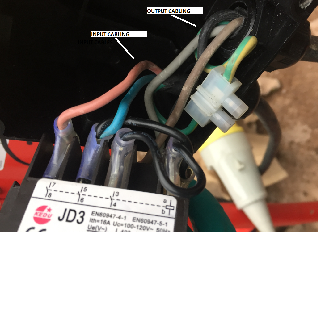

No power is reaching the terminal block. Which is odd because the other day there was some voltage.
Results :
104V into NVR (at +ve and -ve terminals on input side)
104V out of NVR (at +ve and -ve terminals on output side)
But nothing reaches the terminal block.
No damage in NVR to terminal block harness.
My original thought was the cut in between the plug and NVR may have shorted or blown something in the NVR?
I ran the bypass (basically severing the plug to NVR harness where the cut was ... leaving the earth still running to NVR and wired +ve and -ve into the terminal block and the motor fires up.
Is the issue likely to be the NVR contactor?
Do I still need to check the auxiliary winding and centrifugul switch?
Could there even be a break in the 4-core cable?

I think you may have cracked the case Lucien !
Continuity across each pair of terminals on NVR when I press the button so NVR looks ok
BUT one wire (the grey one) has no continuity from NVR to white terminal block. The brown and black do. So even though the cable looks pristine there must be a break in the grey. The cable is fastened to the frame which is a fold down and fold up all in one u shaped handle and I suspect the frequent folding down (to gain access to grab handles for lifting .. it weighs 50kg ... you cannot lift by the handle there are special grabs) and then folding up to use the plant (or storage) must have weakened the grey wire and its broken.
Will replace the cable tomorrow and update you.
Thanks you ever so much for all your help Lucien. Much appreciated.
Next job is my 240V washing machine motor (which is not running or even offering) So I may well be back on here within the week after I have done some basic tests ...
Result! So you had line continuity from the NVR to the motor feed and a return to hold the coil on, but no neutral reaching the motor itself. At least it's a much easier / cheaper repair than something deep inside the motor.
