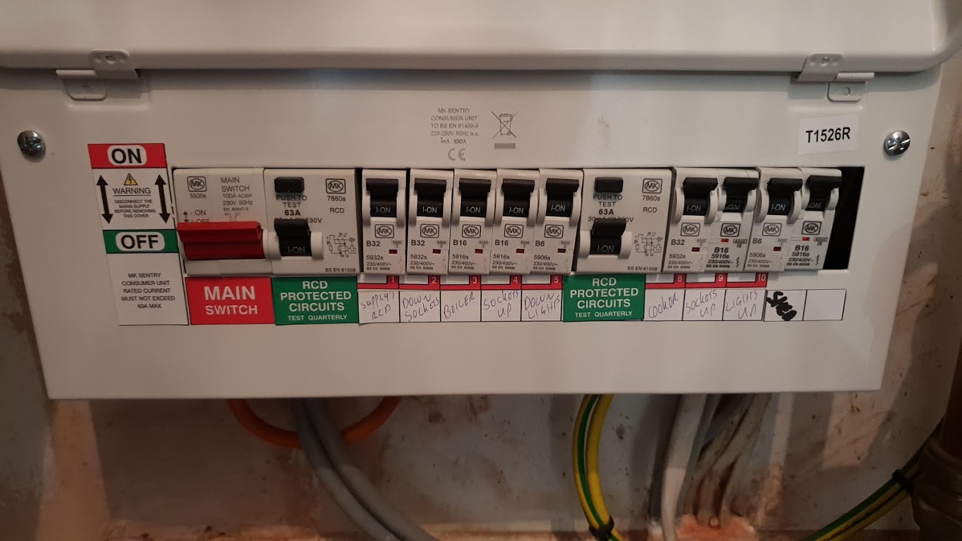

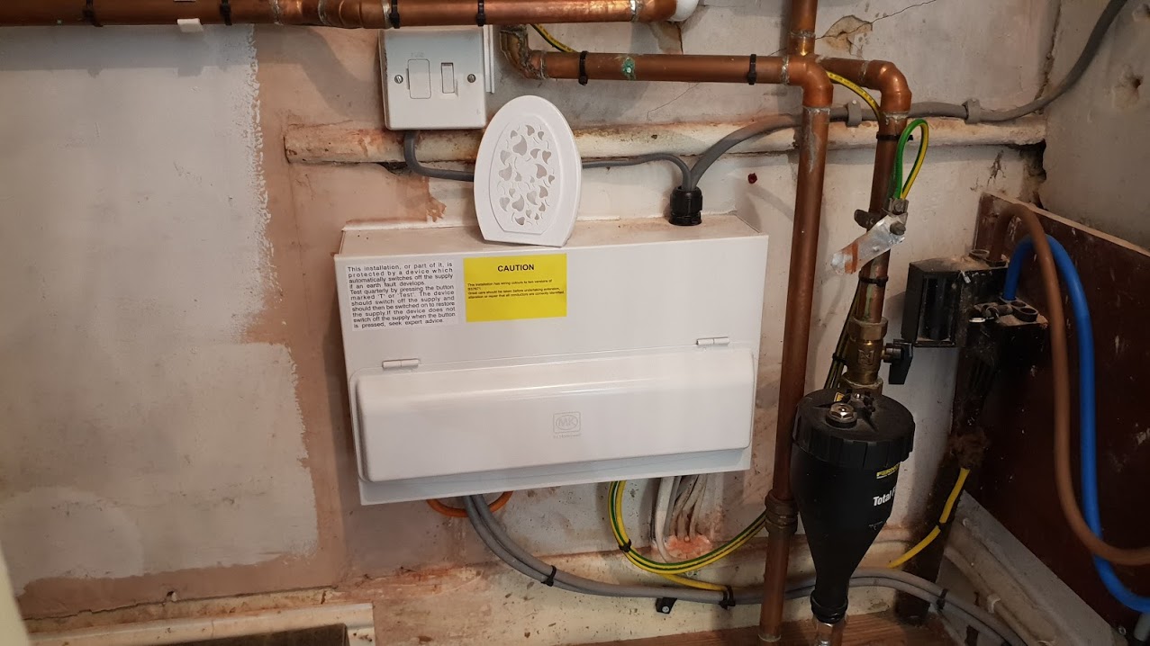

Hi all
We're moving in to our first property - it's a 1950's build. The house has been bought buy a property developer who bought it from the previous owner so that they could purchase a new build (part ex).
We had a survey done recently and one of the things that has come up is the lack of any kind of electrical certificate for the consumer unit. The property developer's solicitors have said that the previous owner had not had any electrical work done since they moved in (pre 2005) and as such a certificate was not required.
Fortunately I had the foresight to take some photos of it whilst I was there and to me it certainly looks newer than something that would have been installed 13-odd years ago. It is a split load MK CU with RCD etc. It's a metal box which as far as I'm aware is a recent requirement (17th edition?) and may not have even been available pre-2005. I've attached a couple of pictures to this email.
In my opinion some DIY'er or whoever has installed this unit without being qualified and obviously not able to supply a cert. But that's just my opinion - any help on identifying the year of this model would be appreciated.

No, it's a metal MK Sentry Consumer unit of current design. I've fitted a few.
In England and Wales (Part P 2013 and 2010 editions respectively) there should have been a notification submitted to the local authority building control that the consumer unit has been replaced. There should also be an Electrical Installation Certificate for the work (a consumer unit change requires this).
Whilst metal Consumer Units have been available for donkey years, the particular Standard which the one in the picture is manufactured to has not.
That particular standard was introduced on 31/05/2012.
It would not have been possible to purchase a Consumer Unit manufactured to that standard prior to the standard being introduced.

Lovely- this is what I knew a little about and just need clarification on- am I able to contact the LABC to request this information or should I leave it up to our solicitors?

It looks quite a tidy job, on the outside, to be honest, maybe done as a result of a cash only job with no certificate, not sure of the date, but if you are worried insist on an Electrical Installation Condition Report, (EICR) could be around £250:00 but who pays is unsure, as I have no information as to the state of the purchase.
As said, this board was not available until changes to the regulations in 2015 prompted manufacturers to make metal consumer units.
An electrical installation certificate and building control certificate should be available, but not likely to be seeing as the homeowner is lying.

Knock 500 notes off the price subject to an EIC certificate or insist on an EICR paid for by the Vendor
Get them to pay for an EICR, you could pay and try and get some money knocked off the purchase price.
Also insist on 100% of circuits to be completed.

Hi @Benuk. Personally I wouldn't sign anything until you have seen the above or after one is done. You do not know the condition of the electrics and as you say, if they have lied about this then you never know what else they have done.

OP, you could do a search on your local authority web site, to see if the new consumer unit change has been notified to them at that address. Such as you can for planning permissions, building regs approval on building work (thats if you reside in England & Wales). If it had been installed complying with Part P Building regs, it will be listed on the LBC web site. Not that will get you the required certification, but its a starting point.
cynic in me says maybe the new CU is there to make the installation lookt he dog's bollox, but behind the walls there could be the pig's arse. get an eicr done as a start.
Inspection and testing of electrical installations has been required by the "wiring regulations" since 1882, the first edition, it is there, I have a copy.
Certification has been required since the 14th Edition, my version is 1970.
Notification of such changes to Building Control under Building Regulations requirements has been necessary since 2005.
BS EN 61439-3 was published on the 31st May 2012.
So it seems that the property developer has not done his homework.
One word of caution, if you get an EICR done before purchase, then you will be purchasing the house with the known defects, thus you will have no legal recourse, I've just been there with a house purchase I was involved with.
If you get it done after, and it can be proven that false information was furnished to the solicitors/as a legal document, then you would have legal recourse.
It's an awkward situation, but either way it is difficult to decide, and prove.

is it me as i dont have my contacts in!!! but the tails and main earth enter in different holes on that CU?
Personally I would speak to your solicitor, likely outcome is knock a few hundred off the sale to cover a subsequent eicr and any remedials.
Also any EICR should be done by an electrician of your choosign and not theres as it could be a mate who gives a clean bill of health but really there is lots of issues.
likely though you will get offered an indmenity policy by the sellers side but if they knowingly lie and say no work post 2005 when there clearly has been then its possible it could be invalidated, make that clear to your solicitors as they wont want to be involved in swindling the insurance firms!
safest route is seller pays for building control to regularise it. as long as its not the sellers mate doing the inspection!
Certainly room for it to be a way of price reduction
