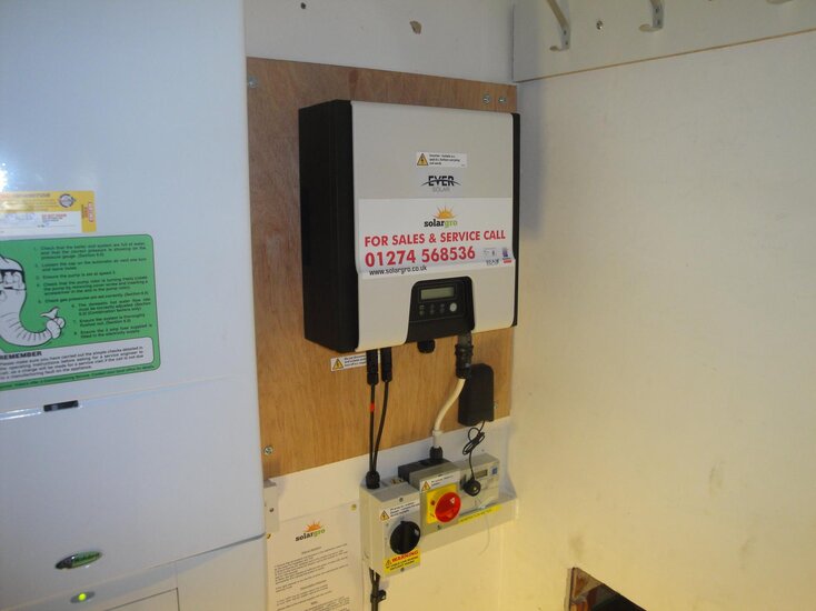

it doesnt have to look untidy, this is was a downstairs inverter job of mine and i dont think its too bad.
I'd be happy with the subs. they're not short changing you on the panels or inverter. it's a great FiT rate at the moment so I wouldn't let it slip away because they could have tried subbing any old tat. In my opinion.
