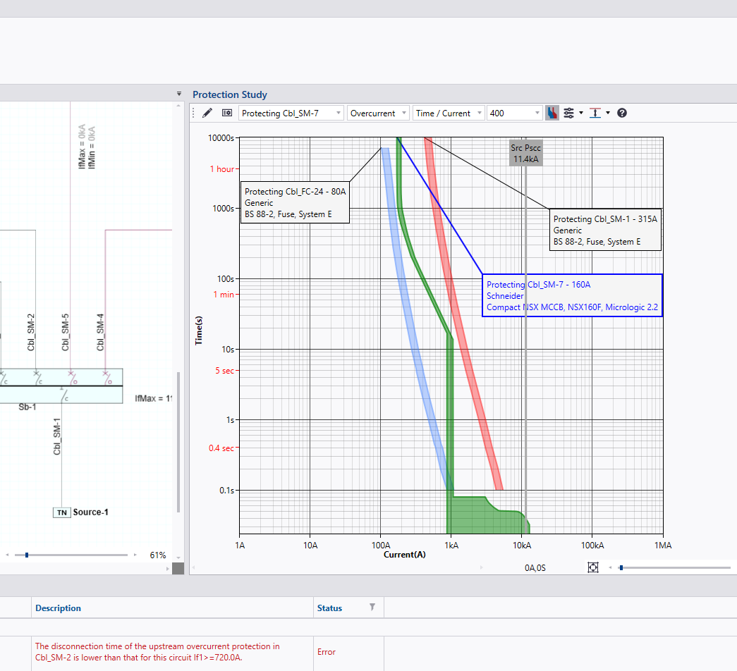

See below current-time graph of the protective devices. The red henley cut-out fuse is not modelled in Amtech so just the 80A fuse in the MSDB is used in the calculation.
You can see at about 1kA fault current the MCCB will trip as the 80A fuse curve intersects with the MCCB curve. You might be able to fiddle with MCCB short-term delay to around 0.4s and maybe put it in 'I2t' mode to push that crossover point high enough so you have selectivity at the expected PFC/PSCC levels, but I think that needs the fancy electronic trip module.

I have adjusted the selective short circuit (Isd) from 10.0 to 8.0 and all the errors have gone, thank you so much:

Actually looking at your plot it seems it has just moved the MCCB curve a bit to the right, but the reason it is no longer complaining is it only plots the fuse characteristics down to 0.1s, which is not terribly clever (but not unique). There is still some risk that at 1.2kA or so the MCCB would be tripped.
However, it is unlikely that would happen on final circuit faults as then the MCB should trip below the MCCB's short-term delay, at least up to a few kA and that might well be above the PFC/PSCC at that point.
