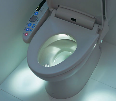

You need one them fancy hi tech japanese toilets, they have nice multi coloured leds in them and will clean and dry your backside for you too. confused the heck out of me when we went to tokyo..
i'd never trust that contraption. press the wrong button and your balls end up as hors d'ouvres in the local japanese restaurant.
I was asked by a customer to fit spur outside toilet thought it was for a towel rail turns out his Japanese wife was having one of those fitted even has a remote
Good way to stop anyone spending to long in the loo
