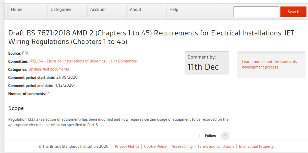

For those that are interested ammendment 2 got released earlier today..
From a quick glance it looks like we will be installing AFDDs for AC final sockets and final circuits upto 32amps with the exception of some safety circuits/motor controls and lighting circuits.
Not looked to much into it yet but looks like A type Rcds should now be used for general use, the old AC RCDs can only be used where there is no chance of DC or control circuits.
Prosumers seems to be added to Part 8...
I believe that Sparkninja is putting on a webinar tonight for those that are interested.

Yup I've logged in to the site but can't get it to work. It's just stuck on table of contents. I'll try again later.

It did say the 11th December, its plastered all over the email I received informing me of the amendment earlier.
The planned publication date is 21st Feb 2022 so I suspect someone screwed up they years and there ought to be a lot longer both for comments and for internal BSI discussions.
Watching the SparkyNinja webinar and they've just mentioned December too,
Has anyone managed to read it without it freezing.

When I first opened the page I'm sure it flashed up as 21st Oct and when I scrolled back up the page a few minutes later it was 21st Sept
Is there a timeline set down for it yet? I thought i saw somewhere that it is planned to be published in early 2022, in which case I assume that it won't be enacted until something like 1st Jan 2023?
