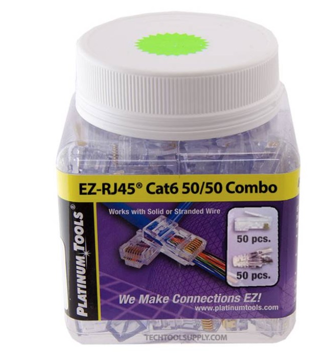

My eyesights gone a bit and I wear glasses, I moved over to the EZ Connect RJ45 connectors as it much easier to get the colours in the right place.
When connecting the ends up stick to the B standard, when I did my house a lot of the cables where terminated into a patch panel so makes it easier using a lead from the switch to the panel.
I used to buy hardware from Black Box, not sure if they sell the EZ Connectors but you'll find them on eBay or Amazon. 13692 - GigaStation2 Surface-Mount Housing - https://www.blackbox.co.uk/gb-gb/fi/1249/13692/GigaStation2-Surface-Mount-Housing/V1.F5173
