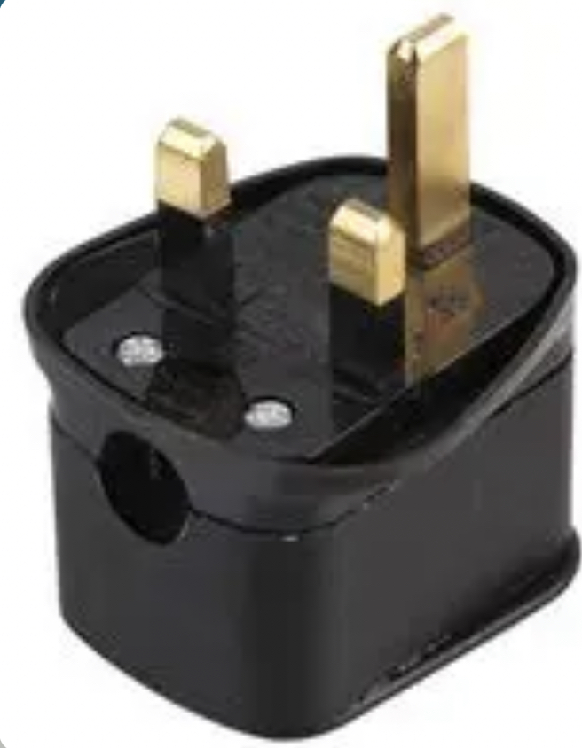

For a specific appliance that is causing trouble to its neighbours on the same circuit you might be better to consider a plug with SPD built in:
Note: such a plug has limited capacity for surges, it won't help much if you get a few kA from lightning nearby!

That's an interesting device you've linked. I'm familiar with power outlets (eg 4 way power outlets) that have built in surge protection. But that device doesn't seem to have something you can plug into? So I'm guessing you plug this into the same circuit as the troublesome appliance, and then it dissipates any excess energy when it detects a spike? Or am I being slow? :)

It's a 13A plug with surge protection built in - replace the normal 13A plug with this.

I believe it's a plug you put on the flex of the appliance you need to protect (Instead of a normal 13A plug)!
