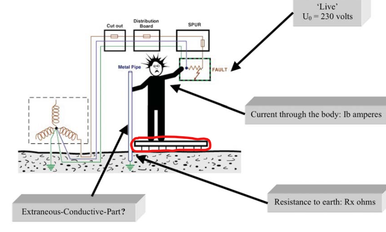

I have just put in a sub distribution board in the middle of a field for a new supply for some poly tunnels (soil heating mats and lighting). I have made it a TT.
I have noticed that they have concreted in a number of separate metal hollow poles (see picture) which will be part of the polytunnel. I haven't tested these yet, but they will test as extraneous. If they remain as they are (i.e accessible) do they require Main bonding?
I do get confused with bonding! Every year I re-read up on it, feel I've got it, and then either forget it or a new scenario comes along!
My thoughts are that it will need a 10mm into the nearby DB as it is an 'exposed metallic structural part of the building', which is one of the examples of an extraneous conductive part (411.3.1.2). However, each post is a separate piece of extraneous, so I need to continue this 10mm around the poly tunnel to each post. Is this right? Or, does it not require bonding for whatever reason?
PS.. there will be no livestock in the field at any time.

So what will bonding achieve?. If there is a fault in a class 1 accessory all metalwork becomes live providing multiple fault paths to "real earth".
I think I would prefer unbonded metalwork in this case and ideally use class 2 light fittings /accessories that may be attached to the metalwork
I'm in agreement with @LastManOnline. As far as I can see, in this situation, all bonding does is give you more chances to die if the RCD fails.
If the person was reasonably insulated from real earth, e.g. standing on a giant rubber mat, then there are obvious benefits to to ensuring that a faulty appliance/light casing and the poles are held at the same potential, so under fault conditions touching either or both wouldn't cause a shock.
But in this case there is an instant ~1000 ohm path to real earth via the human to soil. Touch one thing live, never mind two, and you have a problem. So in this situation limiting the number of items you can touch at mains potential does seem preferable to me.
The only other aspect would be the poles becoming directly live themselves, e.g. a faulty class 1 heater resting against one. As it's TT then we'd be relying on the RCD anyway as limited current would flow. I like the idea of an additional up-front S type 100ma RCD and 30ma RCBOs so you get some redundancy in fault conditions.
Went back there today for 20 mins and tested the posts. They test 101ohms between posts and the same between post and rod.
I didn't do an EFLI test on the posts though, sorry!
I can't quite see how bonding helps in this case.
All posts will have a similar Ra to the rod. If there is a fault to earth the RCD will trip.
If a person came into contact with one of the posts whilst simultaneously touching an exposed conductive part that was somehow live, the RCD would trip as the posts are <1667ohms.
