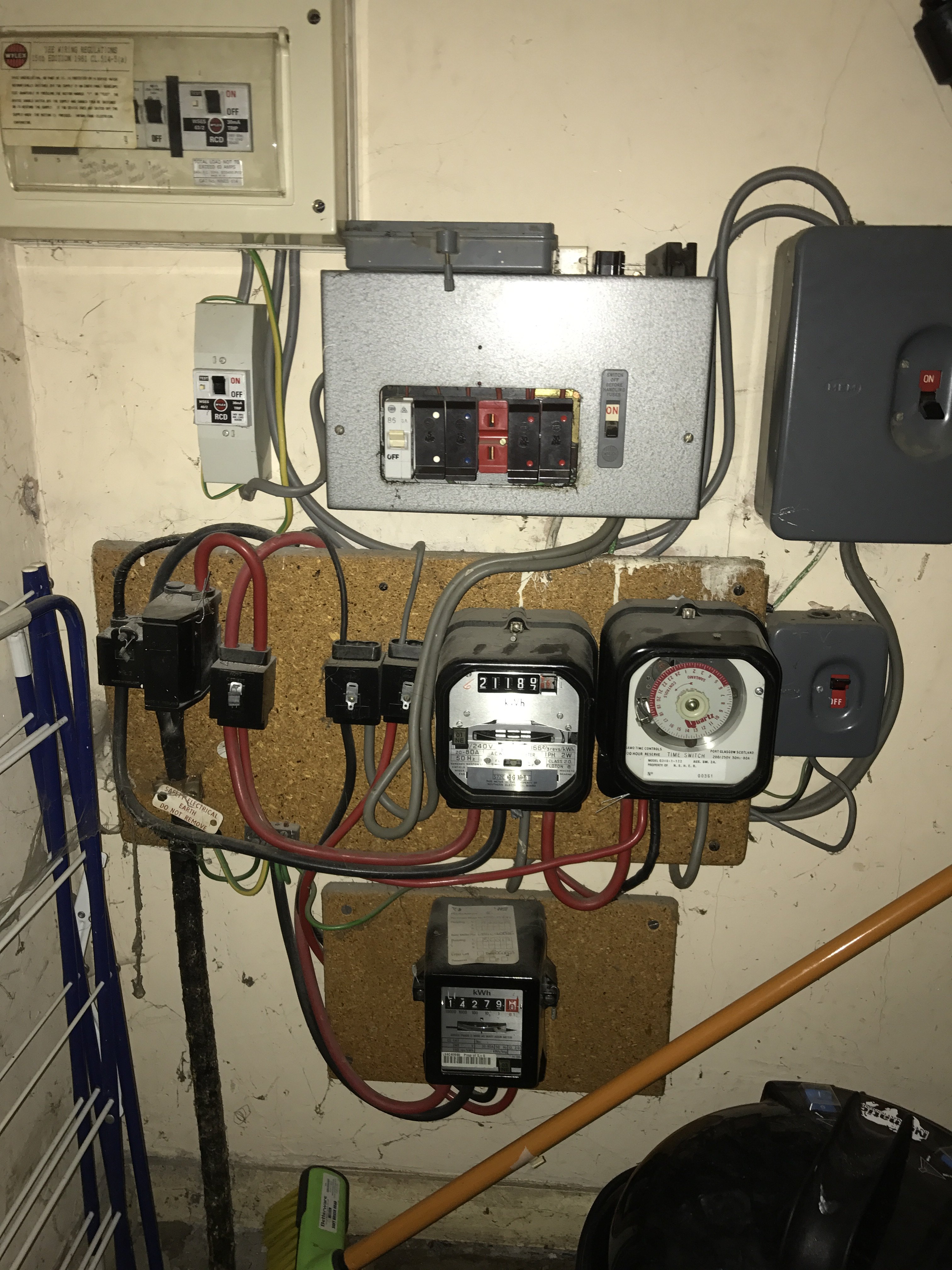

Hi, I'm not an electrician, I wonder if anyone can help me with a few queries.
Q1. Can you explain what this 40A RCD might be for (Off Peak F)?
I have a cartridge fuse board from the standard meter (house built in 1970).
The original heating (fed through the off peak F meter) was obsolete in the late 1980's, and storage heaters installed. The storage heaters are connected to a separate consumer unit (MCB's?) , with a 63A RCD.
What's puzzling to me is that there's a 40A RCD connected between the cartridge board (standard energy) and the 63A consumer unit for the heating (off peak F).
The cartridge fuses are as more or less as expected, 5A lights, 5A lights, 15A immersion (dual supply), 30A sockets, 30A cooker.
If the 40A RCD is turned off everything still works.
Can anyone explain what this RCD might be for/why there might be a connection between the supplies. (It doesn't turn off the dual immersion supply either).

Can you post a picture of the entire set up? as a lay person your post is a trifle hard to follow, no disrespect intended, but we can be a dumb bunch at times and a picture paints a better picture of what has been done. Or at least I can be a bit dumb at times, the others I'm not so sure.

PDF attached!

that stand-alone RCD may have been added to your socket circuit. whatever, you need an electrician on site to sort that mess out.

Here's a close up of the RCD. The white box is the heating (from the off peak F), and the grey fuse box the lights, sockets, etc. It's the 40amp RCD between the two that doesn't make sense to me...!
Here's a close up of the RCD. The white box is the heating (from the off peak F), and the grey fuse box the lights, sockets, etc. It's the 40amp RCD between the two that doesn't make sense to me...! View attachment 37722
it may not connect to the off peak CU, the cable could just pass through or behind. can't tell without the covers being taken off.
Does the rcd operate when you use the test button, if yes pull the fuses from the grey board until it does not to find the circuit it protects.

Thank you! It passes through it, for the bathroom fan heater. There's a fan heater in the kitchen, and a couple of panel heaters upstairs, all connected to the same circuit as the sockets. Assumed the bathroom heater was the same, but no, through this RCD.

Thank you all. Much appreciated to have all my questions answered.In summary:
Q1 - the RCD goes through (not to) the CU to feed 1 heater that was overlooked. My mistake!
