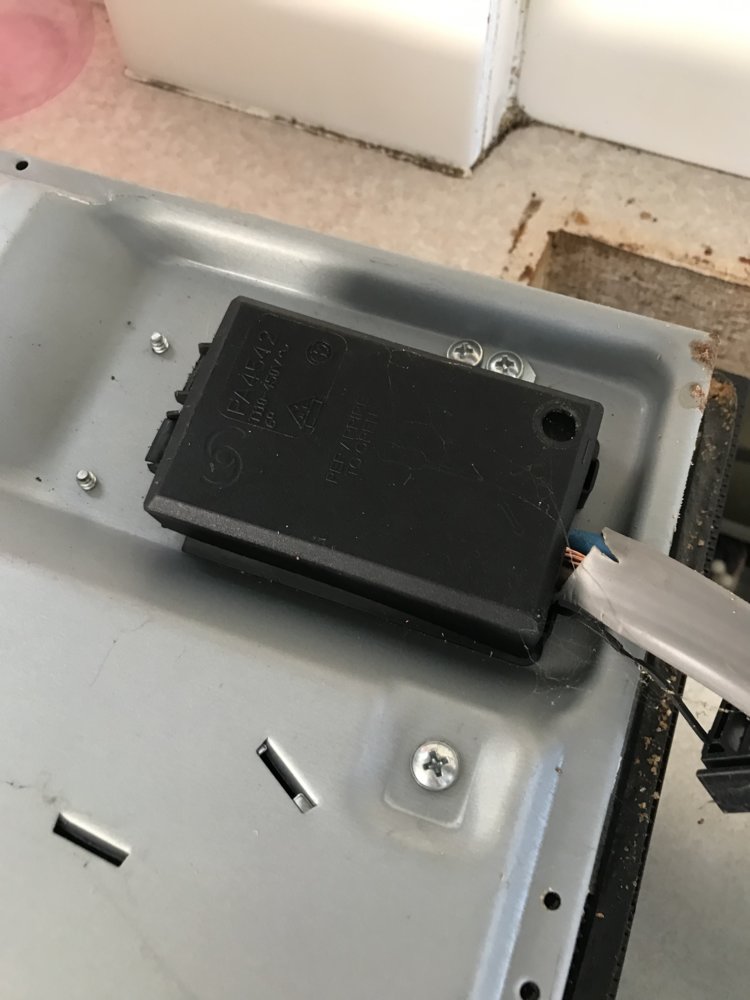

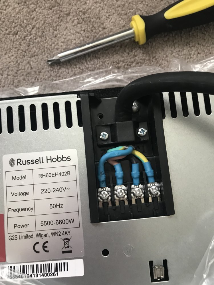

Hi, I’m after a bit of advice please, my ceramic hob has cracked so I’ve bought a new one with the intention of fitting it myself. The new hob has now arrived but it’s got a cable already fitted which has 4 wires, L1, L2, N and E.
The cable fitted to my old hob has only three wires, is it possible to fit the existing 3 wire cable to the new hob? The diagram inside the book for the new hob also shows three wires.
I have added some pictures, the first three are the existing hob and the rest are the new hob and booklet.
I’ve previously replaced plug sockets and light fittings myself, but if it’s a case of wiring the new hob into the wall then I’ll be leaving that to an electrician.
any help would be appreciated,
thanks

L1 & L2 wire to the L
N wires to N
E wires to E
It is kind of opposite to how you put a link in when you only have 3 wires for 4 connections. It allows you to split the load when on a multi phase installation
In some EU countries the maximum size of mcb allowed in domestic installations is 16A. so hobs and cookers are split across two linked mcb's. Usually both on the same phase but can be across two phases.
In my opinion this is much better than the UK way of sticking all the rings onto one 32A mcb.
So as above, link L1 and L2.

i'd say use the brown (L2), blue (N) and E. ignore the black.
Some of the hobs I've fitted, provided links for the hobs terminals when connecting as single phase.

L1 -L2 is for phase to phase on a 3 phase supply.
looking at that diagram for 2nd time, it would appear that both L1 and L2 should be connected to L, for use on 240V single phase. see also post #4. so it appears that both black and brown should be commoned to L supply.

In the 2-phase hobs that I've seen, there is usually a link pin when installed on a single phase connection.

Brown and black to live, blue to neutral. Green/yellow to earth.
Don’t shorten the cable, or cut off the crimps off the end of the conductors.
