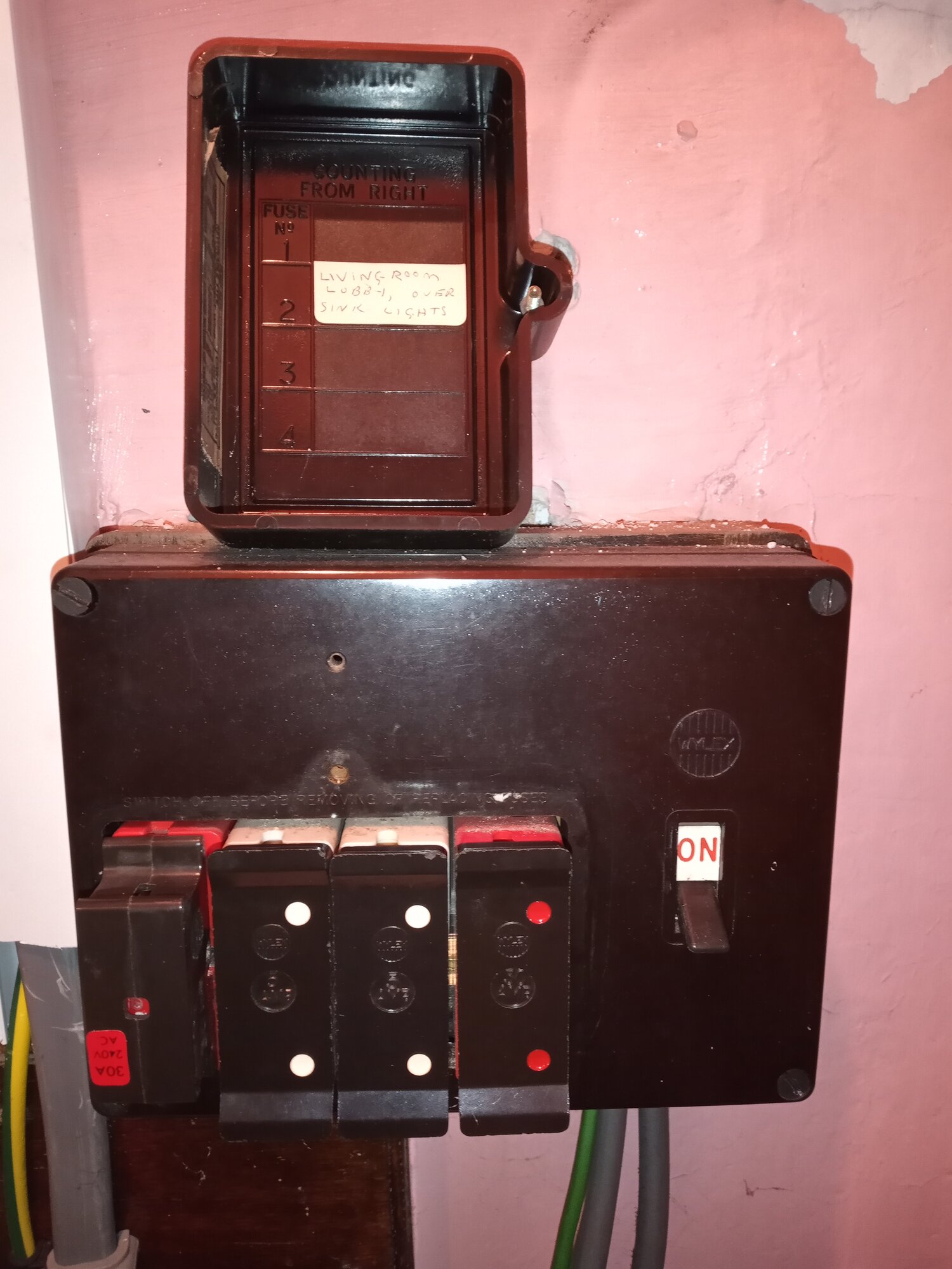

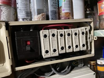

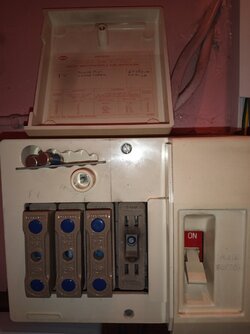

Just for academic interest this style has the asbestos in the fuse carriers:
There is one already out at the moment, when I'm back on site I will compare it.

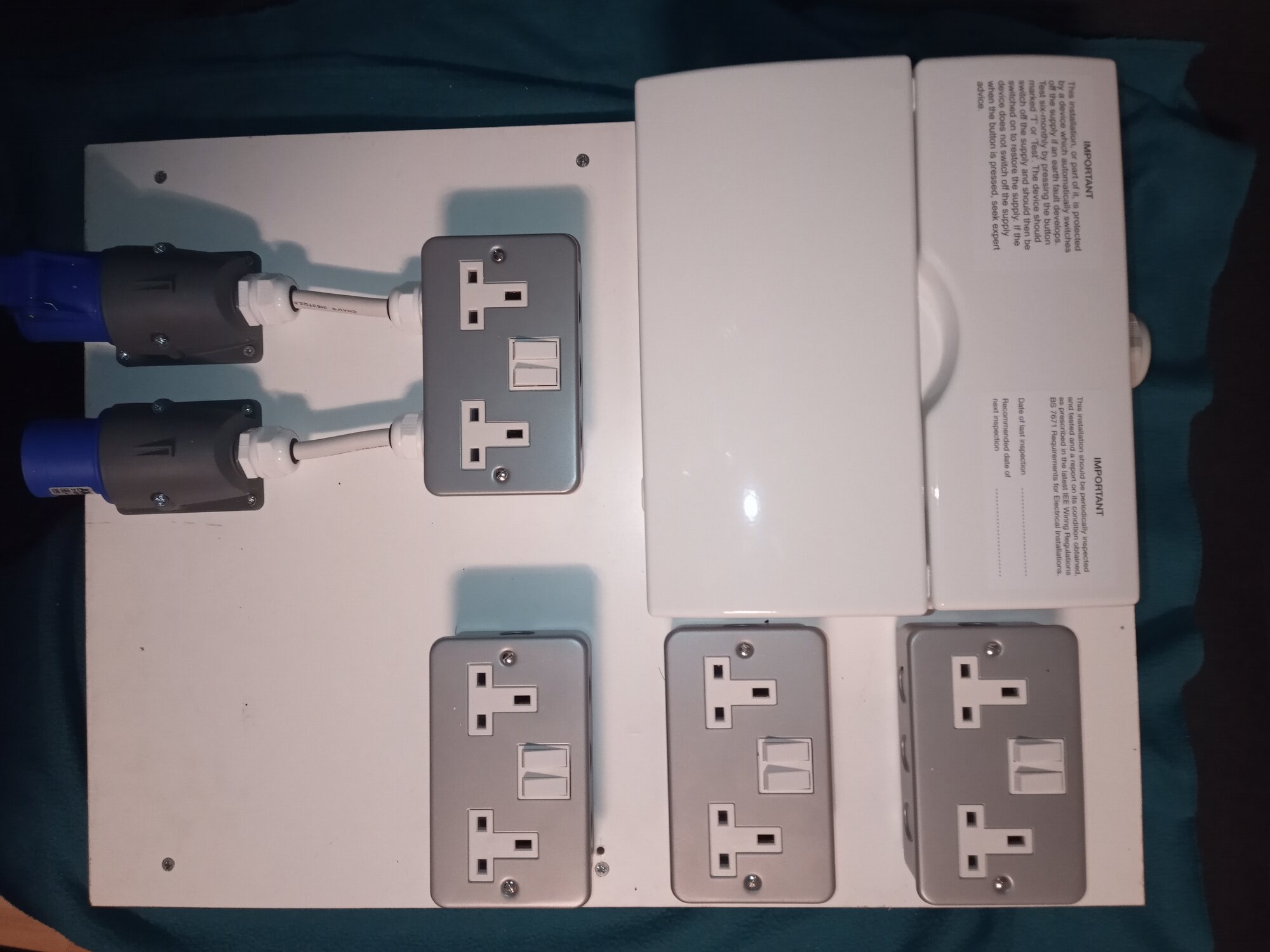

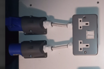

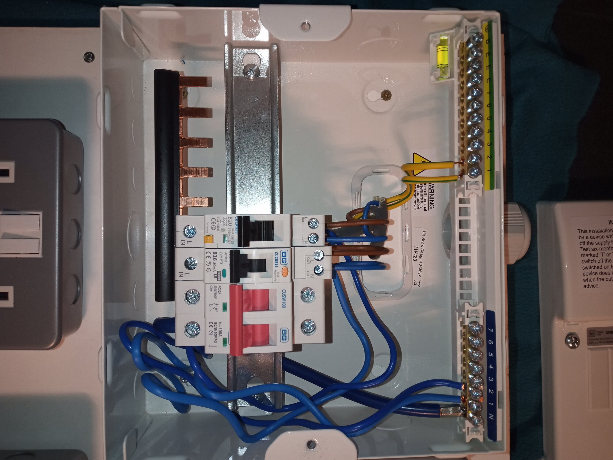

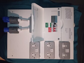

I will be approaching building control to have my work checked and will be getting an isolator fitted to the below setup before I disconnect everything and fit a temporary board.

I will chase it up and see, I do have someone I could approach who wasn't registered to sign off third party work last I spoke to him but he may have taken that on since. Hopefully BC will get in board and it will be straight forward. From looking through their docs they are offering a service relating to electrical work however whether they actually play ball may be another story entirely as has been mentioned above

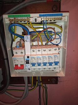

New pics of the boards... Any advice re asbestos?
Thanks
