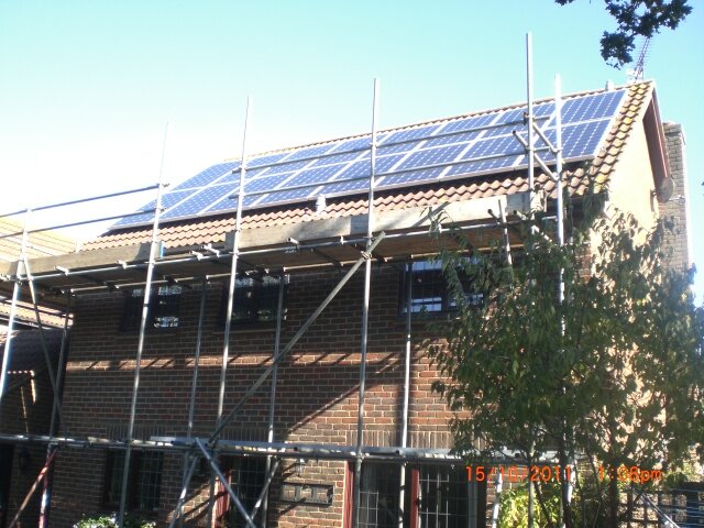

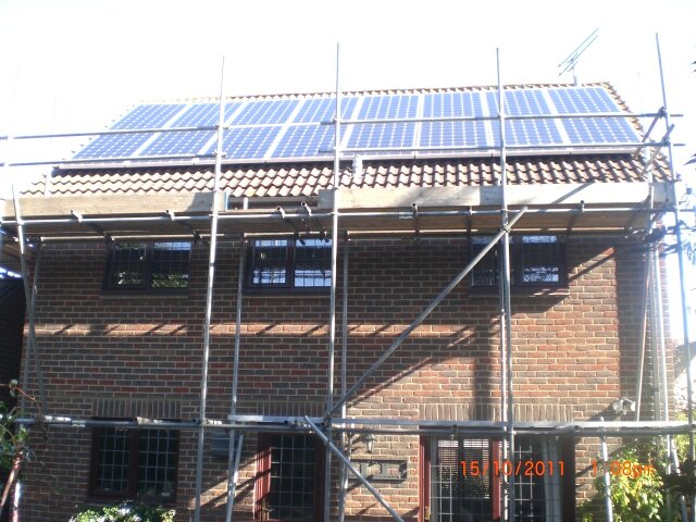

New to the Forum, but I thought i'd share my install info
West facing roof in Essex
16 x 245W sunlink panels
Aurora one inverter
Energy monitor
Both with a 10 year guarantee
All for £9750!!!
The installation went like a dream, a team of 5 turned up at 8am (1 doing the electrics, the rest on the roof)
Real nice proffessional guys, very neat and tidy job, who were more than happy to do exactly what I wanted - even trimmed down my soil vents for me.
Swithched on 2:30ish and even on a West facing roof with a large oak tree giving plenty of shading (which is soon to be trimmed) it produced 6 units and peaked at 2.657Kw.
Paid the final payment over the phone, and recieved my MCS cert and invoice within half hour by email, which I sent off this morning
Got up this morning at 7:30 and it had already switched on, and is now producing just over 2Kw's. Got the washing machine and 1200 watts of electric underfloor heating on, and the meter outside isn't moving!!! Happy days
I really couldnt recommend this company enough, they are a large nationwide company with lots of experience, great customer service and most importantly great price!! They are also offering a limited deal on 16 x 250w Sharp panels for £10,995 at the moment.
Anyway, hopefully the pics below will work and you can see the install for yourself. Any comments welcome

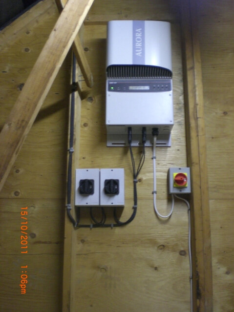

DC cables, DC isolators, Inverter, presence of two supplies, do not disconnect DC under load etc. - the usual set of labels that should be affixed to all installations.

Is mounting on a wooden surface a problem? The Aurora installation manual doesn't mention combustible surfaces. I know SMA had an expert report on the subject for sunny boys & mini central inverters http://files.sma.de/dl/7418/HolzUnt-UEN082610.pdf and there appears to be no major problems.
Can't really tell from the pictures but what size is the AC cable, I would expect 6mm but it looks less than that, as i say though can't really tell just wondered?
No evidence of DC sensitive RCD or array frame bonding for T/L inverter. (safety issue)
No stuffing glands on AC or DC isolators. (safety issue)
Lack of warning labels as per ER-G/83. (safety issue)
Apparently undersized AC cable (loss of revenue issue)
Can almost guarantee at least the AC and DC certificates will be not existant or not worth the paper they were written on,
Installation will probably not be notified to DNO under G83 as that takes time, and time costs money.
I'm not sure it's such a bad install - just not compliant.
Not having warning stickers where they should be is not a major issue for the customer in all fairness. I would be concerned about the inverter being mounted on combustible material and the size of the AC cable. The fact that stuffing glands have not been used on the isolators is a bit shoddy.
Just make sure you get details of the structural survey, DC and AC tests (and Part P notification), warranties, G83 notification etc. May not interest you now, but it will do if you come to sell your house in the future.
Like I say, the install doesn't look too bad to me but it is the kind of reaction you'll get from a trade forum. It's not because people want to pick holes, they are simply trying to look after the customer.
