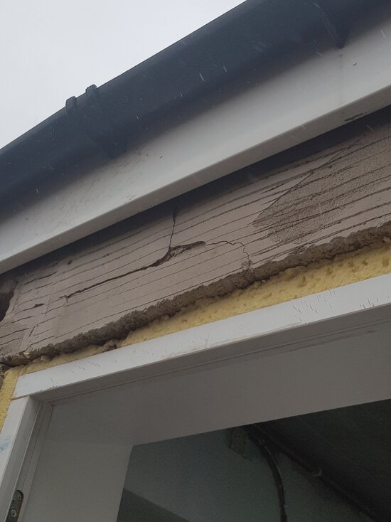

Theres no lintel. "Builder said didnt need one cos its an extension" cowboy and ran off. Told him sort the garden light couldnt do that
It might be worth getting that checked out as it looks like the timber doorframe will be the only thing supporting the roof structure or whatever is above the door opening at that point.

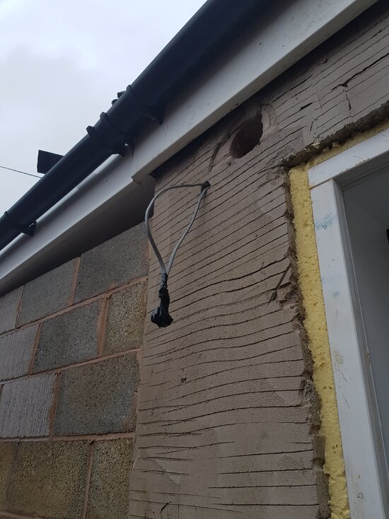

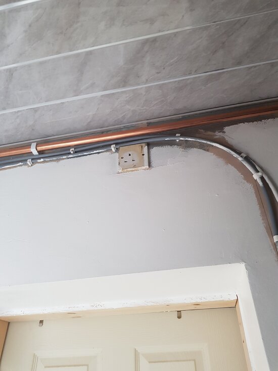

Yeh im going to find someone to look at it. Walls needs to be plastered outside to. Do you think I can report the builder cos it looks dangerous to me. When he done an extension through kitchen to make bathroom he didnt even get wiring done directly from consumer unit. He used the security light wiring for the bathroom.
The two wires are loop in and out and they look like 2.5mm so potentially part of a ring main so you'll need weather proof 13A FCU but to be honest the whole set up looks sketchy so I'd recommend getting an approved electrician to have a look.
