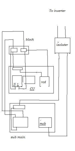

Can I just ask if the enclosed schematic for addition of block and sub main looks like a reasonable proposal? Would pm one or two of you but can't find a way to attach a file pic that way so apologies for thread hijack, albeit related. My meter and main fuse seals are intact. I believe splitting the meter tails on a block would be cleaner but in order to avoid breaking seals does this look like a reasonable way to add a block and sub main for the pv from the mains switch in the existing CU? I have no isolating switch between meter and CU (if I knew then what I do now I would have requested one when meter was changed last year!). Existing CU has one spare way on the 30ma RCD and SB4000TL guidelines clearly state it will trip 30ma RCD. I should add I have no intention of doing this work myself just wishing to avoid looking like a complete ar.e by suggesting something stupid to my installer if he doesn't initially suggest it himself. I believe this is going to be the best way to install but it also has the incidental benefit of being easily able to monitor house consumption with a clamp on the neutral wire feeding the existing CU neutral bar from the new block. Any comments?

I try and avoid lofts as I've posted before I tend to run pv cable in separate conduits , although 2 core swa is fine, but I have read the Germans will only use swa if there are string fuses because if the cable does get damaged then you have the shock/ arcing factor and there is no short circuit protection on Dc side.
Re heat most inverters have electrolytic capacitors which wear as do most electronic components, these have a reduced lifespan and can fail if used in high temps, the rating on an inverter of 60 C will mean that when its at max temp the inverter will reduce power or shut down, while the fan operates to cool it down to a temp where the inverter
will start up again and so on, this will mean in the best irradiation conditions the inverter is reducing power resulting in reduced output ,so you should give it some consideration when deciding the position
