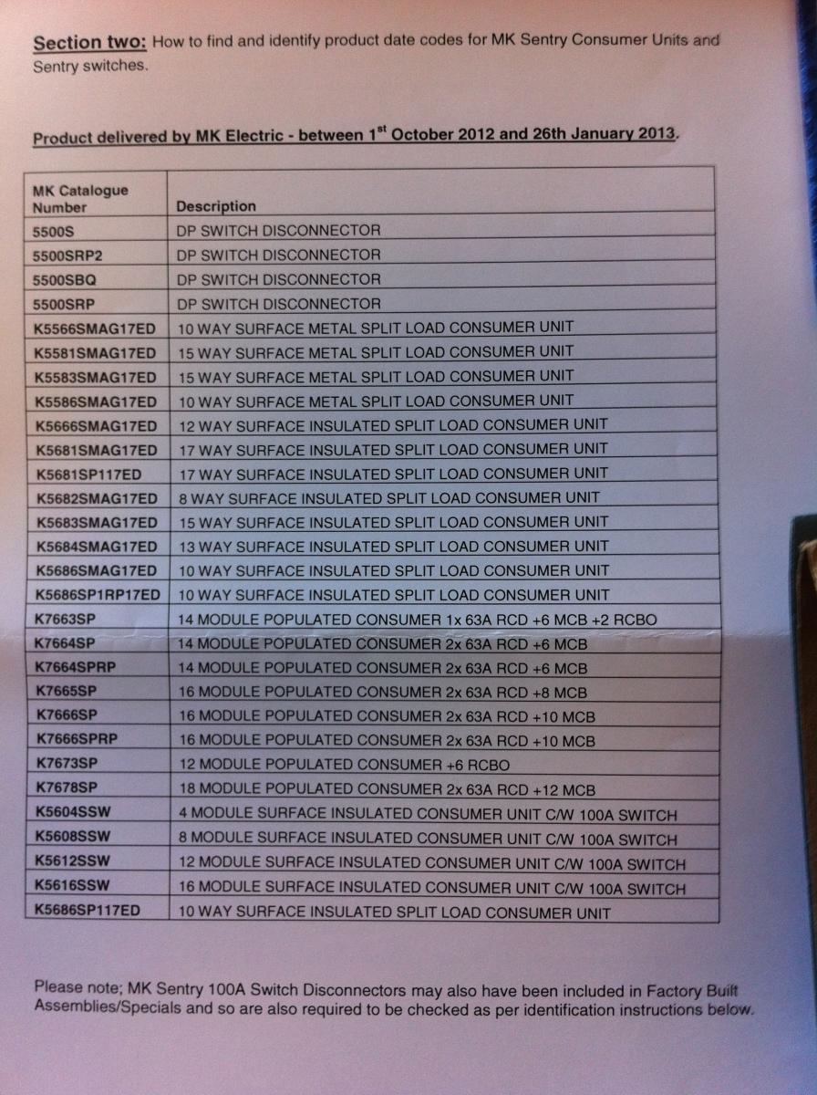

Received this in the post today. See relevant contact numbers enclosed. Sorry the images aren't as tidy as they could be but if you double-click on the individual images they will become clearer, i'll try to tidy them up a bit this evening. Thanks, Eoin

Not a mention on their website anybody got a PDF copy that makes it a bit clearer what code numbers to look out for plus what are they paying if you find one
Those four pages are literally all we've had so far oldtimer, no mention of compensation on them and i can't see anything about compensation on the mini-site either: SwitchExchange
