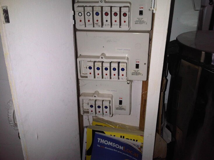

Hi All,
Please see pic of CU's in question,
I agree with you on the 15 amp on CU 1
So what to do, Swap out CU 1 so it includes an RCD (s) or number 3 to include RCD?
Leave number 2 alone, and test the whole circuit, (probaly needs doing anyway as it's a rental property, new tennant 18 months ago, should have a ticket but not had it confirmed)
yes they are the early retro fit mcb i was thinkin of, and what to do will depend upon the budget, i personally would start the job off with a periodic report as being a rented property it should be done. Then to replace cu3 and move the cicuit and rcd protect cu3 only would be the cheaper option, but i suppose to replace cu1 would be the more correct approach. 1 thing tho i cant see from the pic are they the wooden backed cu ? if they are then i would code all 3 as code 1 as the cu is made from a combustable material then replace the lot as you will not be able to make any alterations to them. might have to adjust that cupboard slightly tho tight in there lol :)

tbh it doesnt look like this circuit is goin to reach down to the bottom board either unless they come from floor up but i think he will still have 4 eco7 circs in use in the middle board so eco7 meter would have to stay i think.
