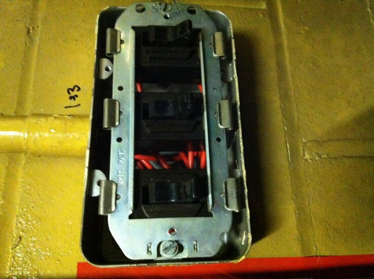

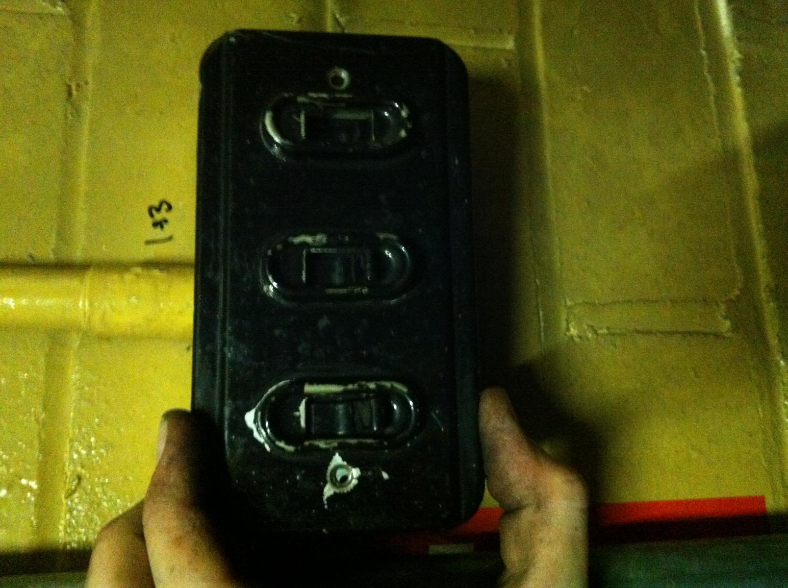

I've come across this switch on a rewire and with abit of tlc I think would look nice in my outhouse :)
It there any current regs tho that won't allow this?

If its eartheable (being metal-clad) then I don't see a problem. Looks fit for continued service to me.

the ones in the pic look like some kind of grid switch....as has been said...test first to verify the movement functions as it should...and as long as you can terminate the CPC to the shell...good to go...

Nothing wrong with that switch apart from the paint on it, I literally have connected thousands of them up, well hundreds and hundreds and never known one go faulty, better than half the crap they sell today.

They look like the old MK mk 1 series grid, they tend to crack and arc on discharge lighting unless x2 rated, the worse that could happen is they could weld up or burn out. If they haven't done already, probably best to use new ones, it'll save you the job of replacing them in the near future.
It's all working fine and switches are stiff and sturdy. I think It looks abit retro. I've got a new mk grid switch that I could use but this looks better. Oh and it'll def be getting a lick of paint (white).

I've got a single double pole switch the same aswell on this rewire, i think that will have to be used aswell, it's nice for things to match :)
