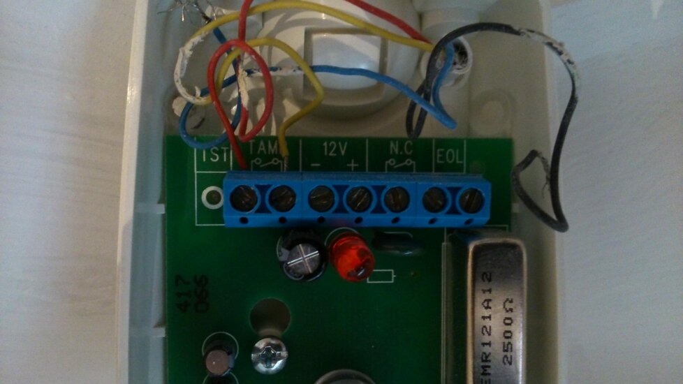

I have opened the PIR and there are only 4 wires (red, yellow, blue and black). The red and yellow are connected to TAM but the blue and black are not connected at all so I wonder if these came out when the builder knocked the PIR.
The other sections that wires could be connected to are 12v-, 12v+, N.C or EOL (see image below).
Can anyone advise me which wire should go where in order to get this working?

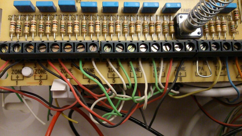

I have taken a photo of the control panel with the cover off.
I know that the zone affected is zone 8 if that helps...
[/FONT]DSC_0027.jpg
OK there is only a 4 core at the pir, looking at the panel, zone 8 is black/red which should be connected to nc terminals on pir, if blue and yellow are connected to 13v aux on the panel, then this should be 12v terminals on the pir

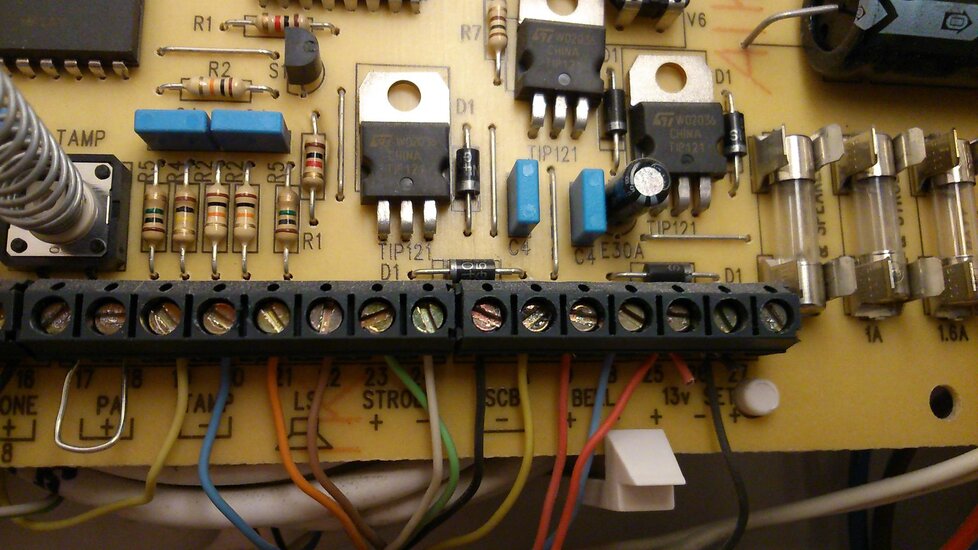

Here is a photo of the control panel a bit further along.
Does this shed anymore light on things?
Right that shows red/black in 13v also....???.
Ok we need to find 12v supply, so either test red/black for 12v with a meter, or connect into 12v and see if led comes on when movement is detector........if red/black is supply, then blue/yellow connect to N/C
Ok, there is a hole for 12v- and a hole for 12v+ in the PIR.
I haven't got a meter so do you want me to take the red out of the TAMP hole and put it in the 12v+ and put the black in the same hole?
you may end up damaging the panel. best to get someone competent with alarms to fix it.
red in +12v terminal and black in -12v terminal.....going for power first so we dont blow fuse
Cheers Taz, tried it but still nothing.
