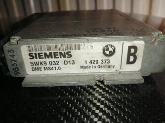

ok perhaps I did not explain correctly , the rev counter is a stand alone type so not into the loom , cable directly from the ignition live , neg earth (body) and then to ecu ,it was as I said working fine before and I have not moved any of the "dip" positions I attach a pic of the ecu in the hope it might help ?, However using a multimeter 0 to 600 range I get no reading off pin 36??

Had a 5 series M52B28 in the workshop this morning for tyre pressure checking, so while it was there I popped the bonnet and connected my DMM to pin 1 of the diagnostic. This has the MS42 ECU, which is near enough the same as the MS41, but with a control output for the second vanos.
DC volts produced no meaningful reading.
AC volts produced a reading of just over 1 volt, which increased only very slightly as the revs increased.
DMM has a frequency setting, which produced sensible results.. About 33 Hz at idle,, which increased with revs steadily. Read 100 Hz at 2000RPM.

Hi thanks for that ,I do appreciate your replys and help and to be honest and not being skilled (or anything ) in this field I am at a bit of a loss , i have another stand alone rev counter which I got to try in case mine was broken but it gets nothing off pin one on the diagnostic or 36 on the ecu ???
mystery ??
