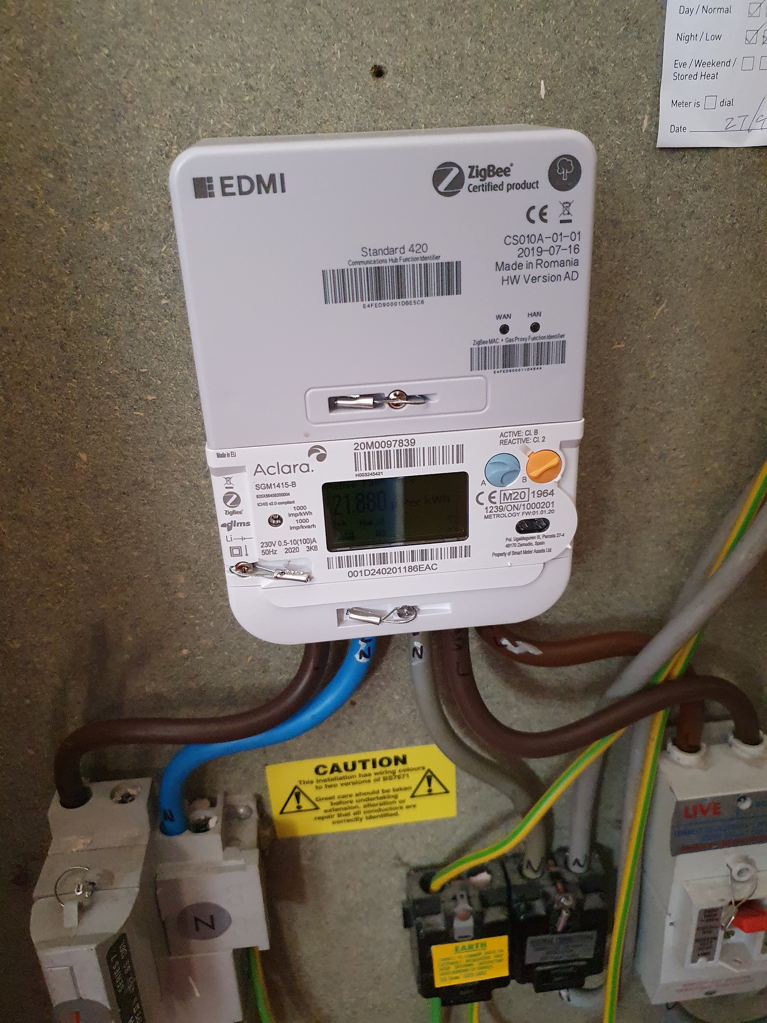

A Memora 2000, yes. I noticed that coming up in my research alot as the RCD but often the threads i'd find would end without any kind of eureka solution.
If I could confirm that the two live wires coming into the meter are separate Night/Day wires it would be quite suggestive. Here is what I mean.
Oh, I had to redo my post after registering and missed a key detail; when the main breaker trips the power is not cut off to the whole house. The Kitchen and Living Room sockets are sometimes left running but the Lights/Upstairs sockets always go out.

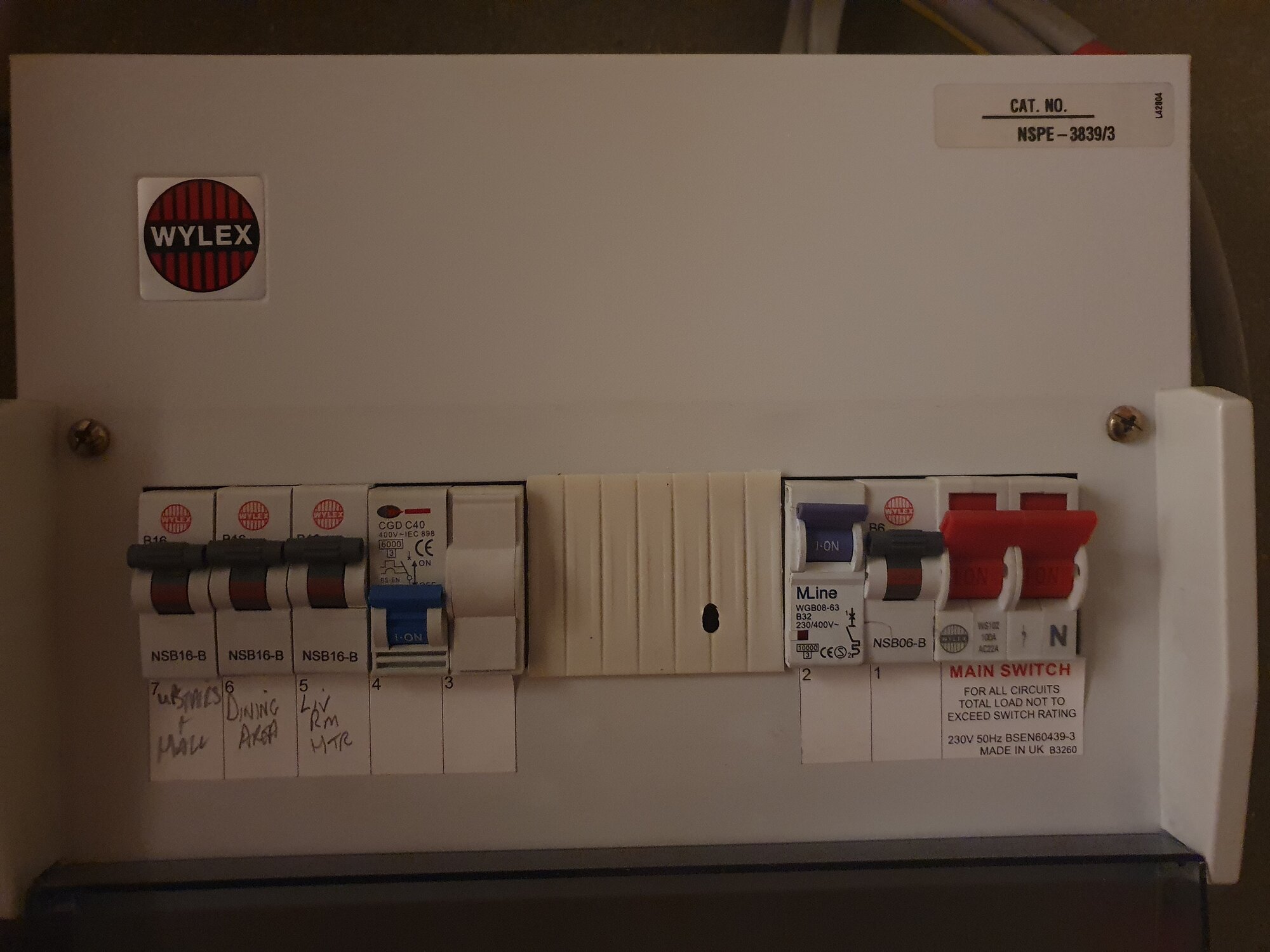

If you have or could obtain a wider photo showing the consumer units too, it would help.
But yes, the two brown tails on the right of the meter are for the different tariffs.
I got some photographs of the complete system, I should have done this when making the OP but I didn't have them to hand.

The second being a complete *ock up by the meter fitter when connecting up the new meter and misunderstanding connections to RCD's
Having studied the pictures it looke like the clowns have escaped the circus again.
Can you do another photo from slightly further back showing everthing in one photo, so we can see where the larger grey cables all go.
And can you confirm which switch is tripping

It's not the clearest set of tails to follow, but I've not yet spotted an issue.
Looks like the lower Wylex has storage heaters on the LH side and other circuits on right, so has both tariffs, and the MEM 2000 has only one tariff.
Unlike other ones we've seen, there seems to only be one RCD in this setup and it's not an up-front one, so the only thing they can get wrong is which tariff goes where, and even that wouldn't cause mis-directed current and RCD tripping.
If the Wylex is only for the Storage Heaters wouldn't it only need the night tariff and the MEM 2000 should have both tariffs?
Edit: Had a look, there's an upstairs heater on the Memara 2000 but that's usually not used. Otherwise Up Sockets, Down Sockets, Up Lights, Down Lights.
The day wire being slightly loose was my pet theory. Anything else seems complicated and certain to lead to replacing a lot of the equipment without being certain of a resolution.
Even replacing the whole CU doesn't seem to offer any guarantees without reasonable certainty of what the problem is.

The right hand side of the Wylex has a B6 breaker, so likely lighting. This CU would therefore need both supplies.
Can you confirm there are no RCD's in the Wylex board, a photo with the flap up would show this. You could also remove the sticker that should have been removed years ago during installation!
