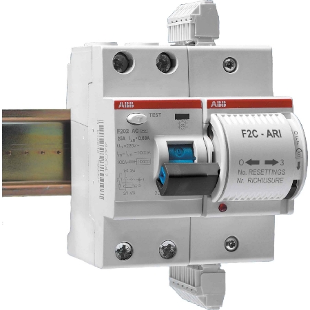

Okay, here's a quick example;
1. What is the device generally called?
It's known as an RCD which is something of a blanket term.
2. What does the device sense and how? What does it ultimately protect against ?
It senses the current flow through the live and the neutral side of the circuit by means of a small CT and some tricky electronics. Any imbalance detected indicates an earth leakage current. The device will trip should the earth leakage current exceed a certain threshold. It ultimately protects people from being killed by electrocution.
3. Does the device provide direct or indirect disconnection?
Direct disconnection on both L+N sides of the circuit (2-pole).
4. Is the device manual reset, auto reset, neither or could be both?
Could be both. This particular device shown has an auto re-closer which will reset automatically for up to 3 attempts.
5. If the device has disconnected does it qualify as safe isolation of the supply?
If it tripped due to a fault then 'NO' it does not provide safe isolation because it could auto re-close at any time. If it's safely operated and locked out then 'YES' it does qualify as safe isolation.
6. In what application (where) are you likely to come across one of these devices?
Protection of final circuits. Possibly domestic but pretty unlikely. More likely in a commercial installation where power fail is likely to cause stock losses.
7. What about this device makes it so suitable for its application? What about the device might make it unsuitable?
It's accuracy and it's speed of disconnection makes it effective at it's job.
8. Give at least one interesting piece of random info about this device.
RCD's were originally pioneered in South Africa with the intention of reducing the high number of deaths of people working on the mines.
Just out of interest when was that last time you checked an RCD to make sure it doesn't have an auto-recloser when you were using it to isolate a circuit? Maybe a discussion for another day...

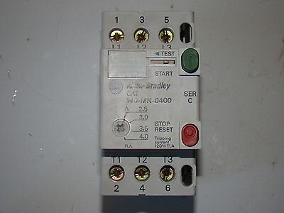

#6
Thermal Overload.
Senses a rise in temperature through the heating elements internally, proportionally to the current being drawn by a motor.
Direct disconnection of all three switch mechanisms (attached to heating elements), and in turn disconnection of all three phases.
(Device specific) Manual reset
No, it does not qualify as safe isolation of the supply THEY ARE EASY TO BYPASS
Motor control circuits - Industrial Applications
Designed to attach directly onto contractors, which control motors or high load industrial lighting circuits
Symbol for a thermal overload:
http://i.Upload the image directly to the thread.com/a7NxBD4l.png
Symbol integrated into a schematic:
http://i.Upload the image directly to the thread.com/0p58RFul.png
Reactions: 3 people
Superb post Jamie. Great info, The symbols and schematics are a nice flashy touch.
The only thing I might add because it's safety related is that most thermal overloads have a selector switch for manual or auto reset mode and this would be an additional reason they're not suitable to consider as safe isolation.
Reactions: 1 person

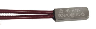

#7
Thermal fuse, or thermal cut-out.
Senses ambient temperature. Under normal (low temperature) conditions, a non-conductive pellet inside the device keeps a spring in a position where it shorts the two leads together. Once the device reaches a certain temperature, the pellet melts, allowing the spring to relax, leading to an open circuit.
It is a one pole device. It provides direct disconnection.
From the look of it, I don't think you can reset this device (one use only, like a regular fuse). However, I can imagine that some devices will automatically reset once the temperature goes down again.
It might do, but I wouldn't trust it. I'm gonna go with "no."
Inside an electrical appliance. Could provide backup protection for temperature controlling thermostats; fan heaters, refrigerators, industrial equipment (thermal safeguard).
(assuming it's the "one use only, melting pellet" variety) - it's a direct mechanical connection, resulting in very low "on" resistance and pretty close to infinite "off" resistance. And they're cheap (~10-50p each).
You need to be very, very careful when soldering these to your circuit board. Think about it... ;)
Reactions: 1 person
Spot on Happy Steve. I thought this might be one of the last devices for people to have a go at but you nailed it early. As you say it's just a thermal fuse. It doesn't reset and it only protects against high temperatures, not over-current. They're used in millions of household appliances such as steam irons and maybe microwave ovens although not so much in fridges and they're just the last line of safety against the thing bursting into flames. 9 times out of 10 if one of these goes open circuit there will be another underlying cause that made it overheat. They can usually be replaced but you need to find the reason it overheated in the first place otherwise you're on a hiding to nowhere. People have a nasty habit of just wiring them out and the appliance will then be a fire hazard.
Just for reference if one of these is blown open circuit there's no way you should consider it as safe isolation of the supply.
You're obviously on a roll so pick another one if you've got the time and the energy ;)

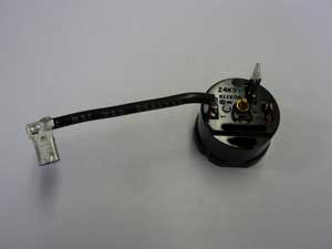

Im going to go with number 1, i had to reverse google the image to find out what this was as i had no idea!
Klixon phenolic overload protective device.
Sensata Technologies’s line of automatic and manual reset protectors phenolic protectors are intended for ½ hp to 15 hp general purpose, commercial and industrial motors. These single–phase and three–phase protectors can be used in single and dual voltage type motors.
Klixon phenolic motor protectors are equipped with a bimetallic snap–acting disc, on which the contacts are mounted, and through which the current flows. If overheating conditions occur, the heating effect of the current flow through the Klixon disc and the influence of motor heat will cause the disc temperature to rise.
When the disc reaches the calibrated setpoint, the Klixon protector automatically opens and shuts down the motor, limiting the winding and shell temperature.
When the motor has cooled to an acceptable operating level — allowing the protector to cool to its reset temperature — the Klixon protector resets automatically to a closed contact position. This allows the motor to restart.
I would say indirect as its used in the control circuit
It could be both
No
Fridge compressors, air conditioning and heating
Sensitive to both temperature and current
Precision calibration
Protects ½ to 5 HP motors
Automatic or manual reset
Fractional to 10hp
Easy to install
UL recognized, CSA certified, VDE certificate
[TD="width: 10"]•
[/TD]
[TD="width: 10"]•
[/TD]
[TD="width: 10"]•[/TD]
trying to find out what it is, what it does and how it does it meant that half of my pizza had gone cold before i had eaten it.
More info can be found here... http://www.sensata.com/klixon/motor-protector-phenolics.htm#uses
Reactions: 2 people
Nice!!! Pizza with a protective device for dessert...can't beat it :)
I'm impressed with the choices, this is another one I expected to be chosen only after the fuses and motor starter had gone.
These things can be found in just about every home, anyone with a domestic fridge or chest freezer has got them. They're specifically designed to be mounted hard against the compressor dome because as you said they not only measure current to protect against overload caused by failure to start (locked rotor) they also directly measure the temperature of the body of the compressor and protect against overheating due to blocked condenser or condenser fan failure or some other refrigeration problems.
Almost all of them are auto-reset and switch back on when they've cooled down. There are manual reset versions available of the same device but they look different to the one in the picture.
In domestic fridges and freezers these things actually switch the supply to the compressor so they're configured as direct-switching and their contacts are capable of disconnecting and reconnecting the full load current or even the locked-rotor current which could be 5 times higher than the normal load current.
Just for info, if you ever come across one of these that's gone faulty there's at least a 90% chance something else / another problem has caused it. They generally only fail if they've been cycling on and off frequently for a prolonged period, under normal circumstances these devices never disconnect. If you encounter a fridge where one of these devices is constantly opening and resetting closed every couple of minutes it generally indicates that the compressor is seized and needs replacing.
Nice work Pennychew that makes the score 7;3 and the remaining devices aren't sniggering any more:)
