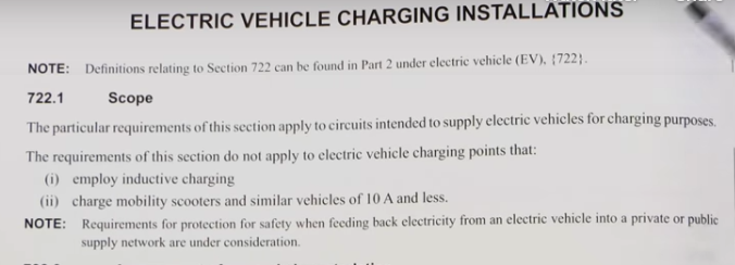

So I am getting an external socket fitted for a tenant to charge her electrical car. She is adamant that all that is required is an outdoor socket (waterproof presumably) even though i have had an electrician round who says it needs a seperate earth rod and dedicated rcd.
I think the confusion stems from the wording of section 722.1 The requirements of this do not apply to electric vehicle charging points that (ii) charge mobility scooter and similar vehicles of 10A or less.
Clearly BMW think that this applies their 5 seat 0-60 in 6 second "mobility scooters" seeing as they have reduced the amperage of their uk chargers to 10A presumably in response to precisely this.
So my question is, is there a definitive answer to this or best practice?

First thing to note is the 330e is not an E.V, it's a plug in Hybrid.
On battery alone it's got a 30 mile real world range according to the reviews.
On fuel it's range is 350 to 400 miles.
If there was such a thing as the Outdoor socket Police, then any attempt to prosecute for use of an outdoor socket for charging a BMW 330e or any other Plug in Hybrid would fail if it was based on the wording in the Regs which specificaly states E.V
(Snipped from J.W's Youtube video)
BMW are not trying to get around the issue as they mention faster charging and charging leads.

My take on this is the tenant has asked for an outdoor socket, it's use is irrelevant.
If a cable is fitted with a 13 amp plug people will just use any random socket whether it's designed for EV charging or not, it's human nature.
IMHO this subject is overly complicated, all chargers should have built in broken PEN detection, but that would be too easy wouldn't it.
I don't like the idea of using a standard 1363 plug and socket to charge a car. The likes of JW and the rest of the E5 group have highlighted the issues a(with the car manufacturers given zero ----s about suitability of the 1363 and implications of you use a standard plug, as opposed to a dedicated charge lead/plug/socket. Best thing to do with the 1363 charging pleads to convert to Ceeform, at least it's an improvement but by no means perfect.
