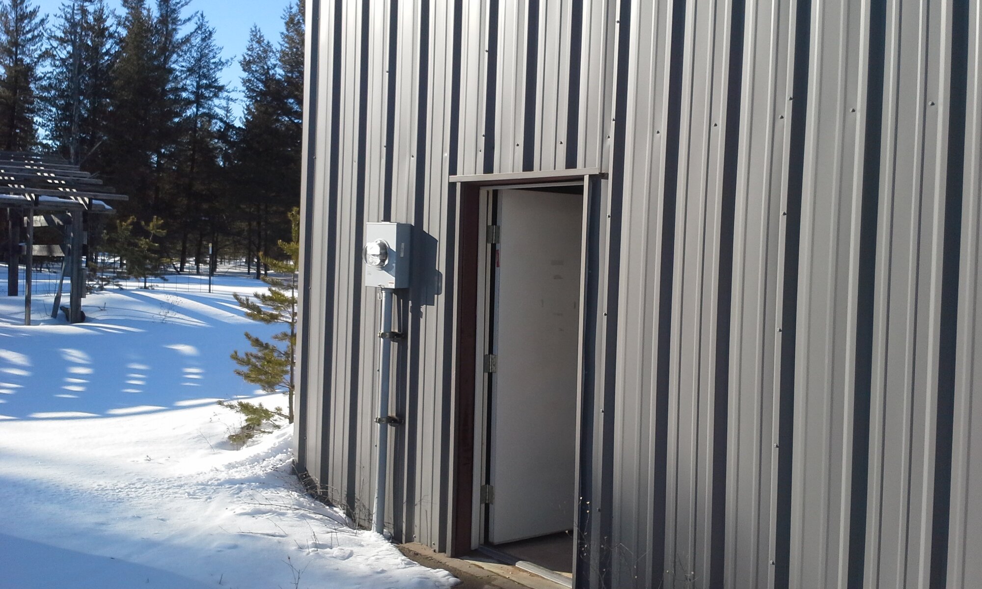

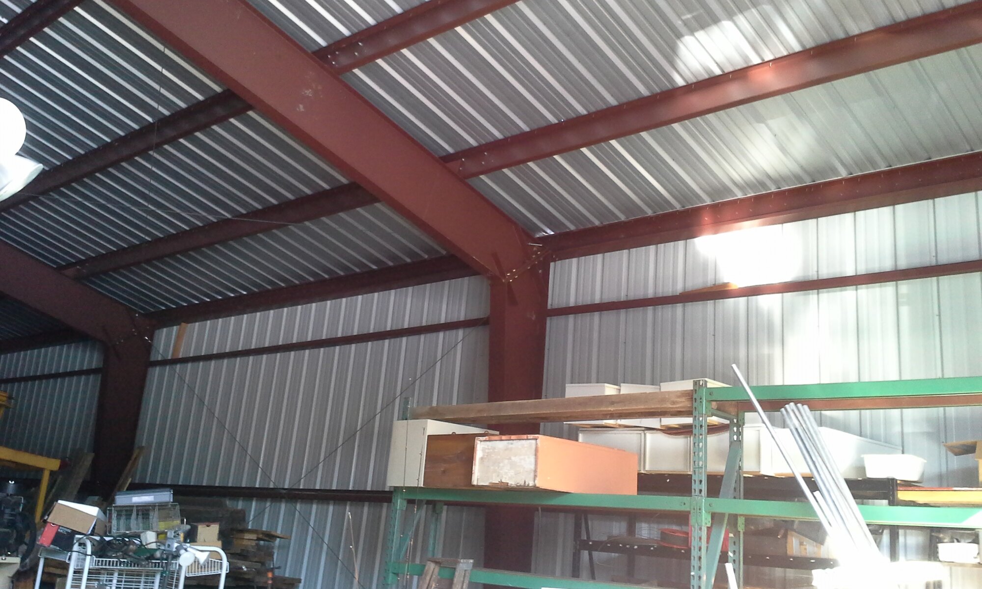

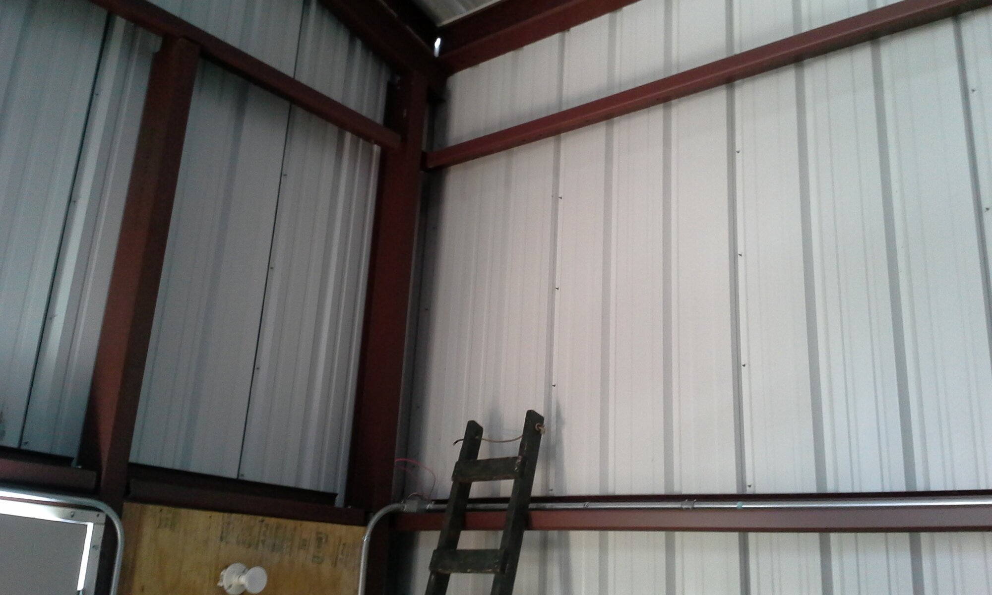

The steel bldg has four large steel posts/Trusses tied together with horizontal steel girts. The top girt is about 12 ft off the floor. I ran 96 feet of 4/0-4/0-4/0-2/0 AL SER cable on the top girt without conduit. My plan is to install two junction boxes at both ends of the top girt and splice 3/0 THHN copper wire with insulated Polaris connectors and run the 3/0 CU THHN wire through 2" Sched 40 PVC conduit into the main power panel. The same will be done on the opposite gable end sub-panel. I already bought the 4/0-4/0-4/0-2/0 AL SER cable and the 3/0 CU THHN wire. I bought the electrical wire off of Craigslist and got really good deals and paid a fraction of full retail prices.

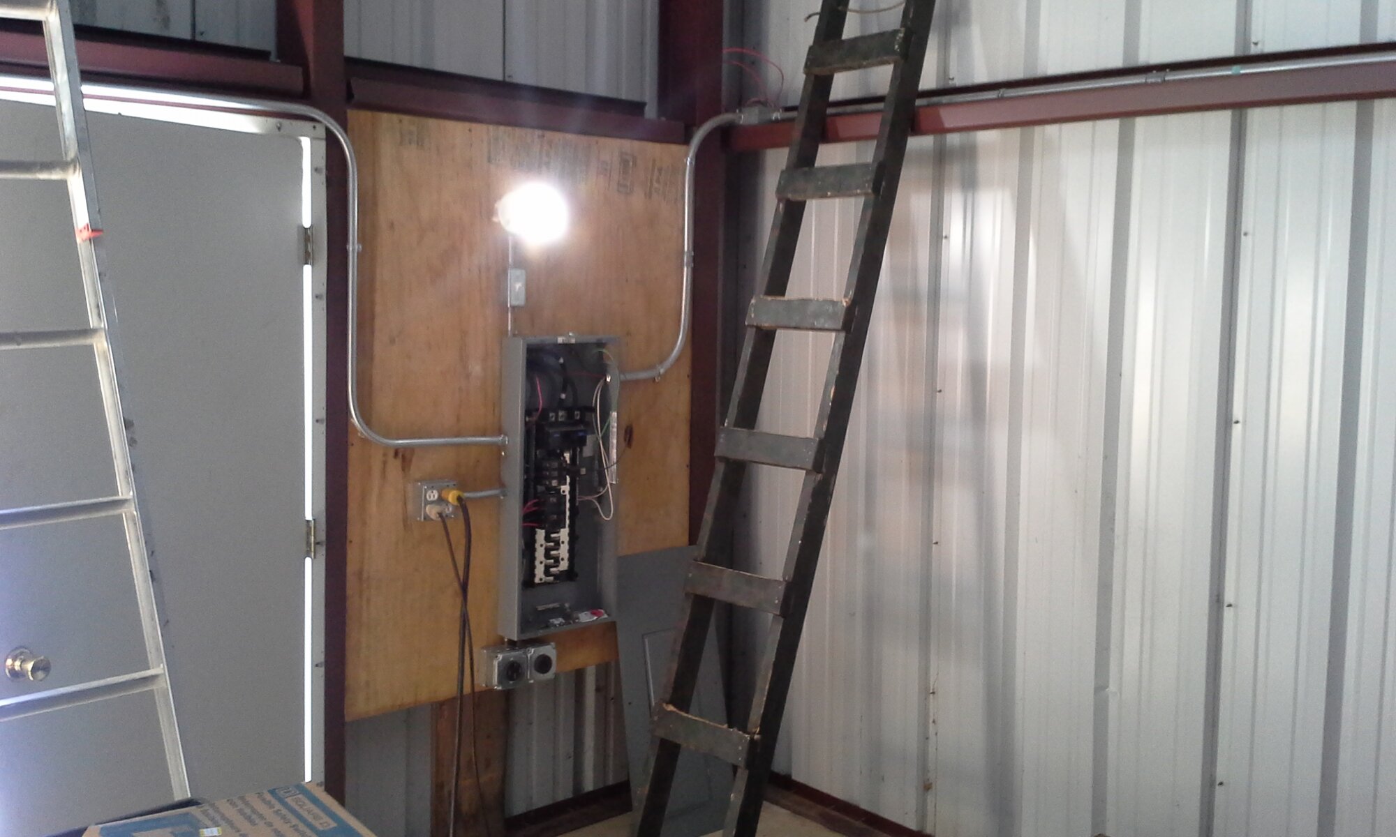

The 2" PVC conduit run will have two 90 deg bends so that shouldn't be a problem. I'll enter the main power panel through the top and then have to somehow run the 3/0 CU wires in the panel and terminate on a 175A Sq D Homeline HOM175BB circuit breakers. Here's what the 175A circuit breaker looks like.
My concern is about the difficulty of terminating 3/0 CU THHN wires into the main 200A Homeline panel where there's only 4" of space between the circuit breaker and the panel side. I haven't bought the 175A HOM2175BB circuit breakers yet. They are expensive ($250 each) so I need to ensure that the existing main 200A Homeline panel will work for my plan.

My friend you need to use 2/0 copper with a 1/0 neutral and # 6 ground. It would save you a lot of headaches. Make sure you bond the building steel, and everything needs to be GFCI protected

I’m not sure what year your state is still using because a lot of them haven’t adopted the 2020 version of the NEC but you are also required to install a disconnect outside beside the meter which is a change in the NEC. Your panels are fine so that’s 1 less thing to worry about.
