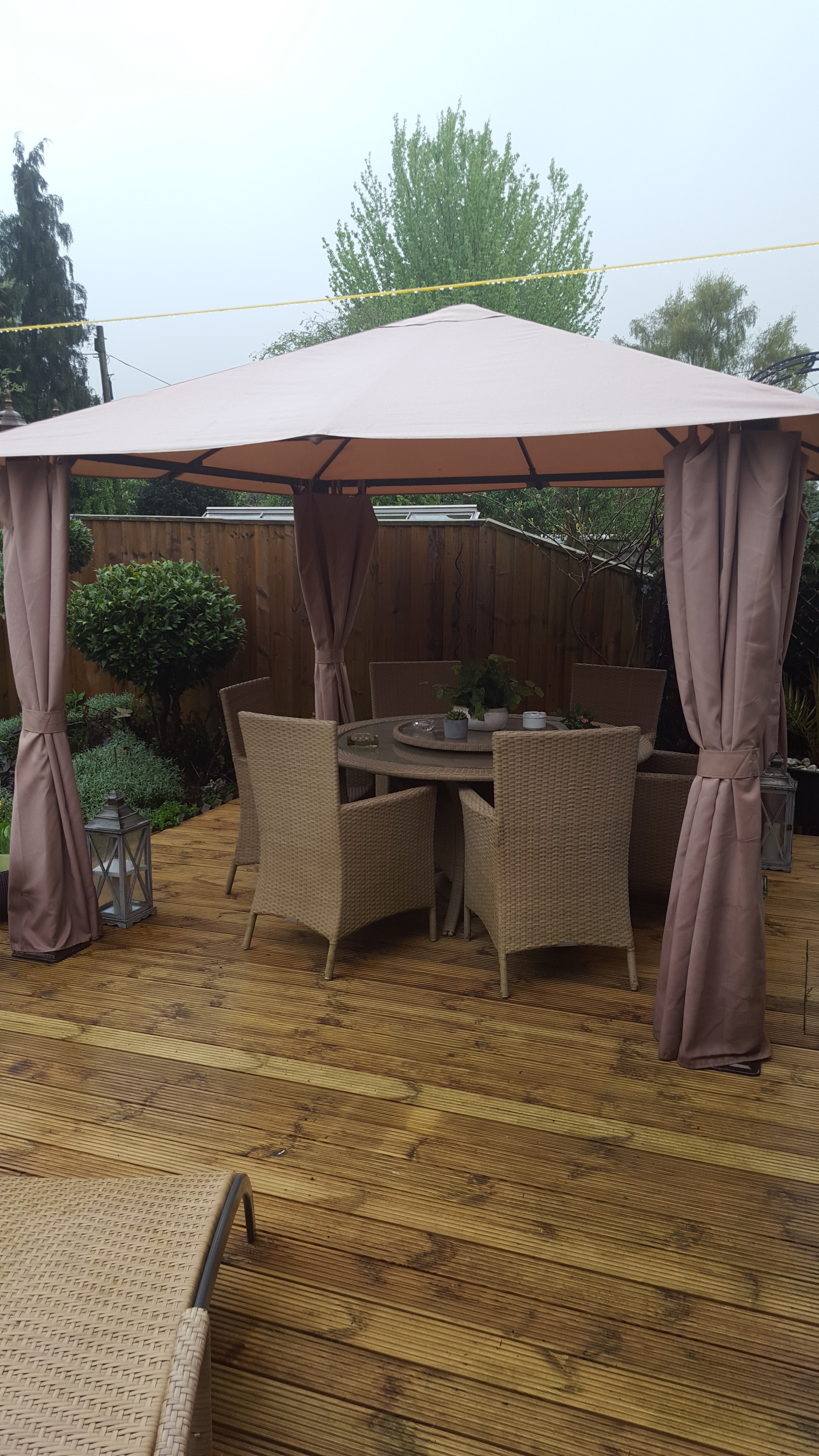

The SWA will have to be clipped to or under decking which is above ground by a couple of foot

a lot of jacuzzis come with an integral RCD. ours has a 10mA RCD moulded plug on it's LV cable.
  • Funny
Reactions: Rpa07
it's round the back that 'er indoors likes to chill.
