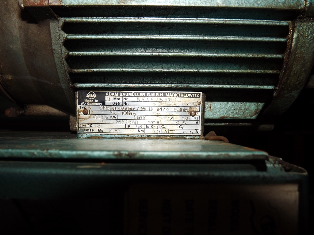

Just thought I would post this pic of one of the motors. I have been thinking about what tony has said and looking into some. I have spoken to some firms about a custom transformer and to be honest, they haven't got a clue what size transformer to make/supply. I am working on the plug on the unit was a 16a 3 phase plug so that would make it 4A a phase. I did a bit of a calculation and got 2.78 KVA total so if i get 3 x 1kva 415v to 66v. Another thing that springs to mind is would I need 415v OR 240V transformers since you only get 415v when you combine two phases, but 240v when you use one phase.
I maybe missing something or just had a brain fart.
Your thoughts please.

A 4KVA 415/110V 3Ph transformer will give a bit of headroom for starting. The actual load is a tad over 2KVA but you need that bit extra for stating. That’s assuming both motors run together.
You are correct tony. take a look at this pic. You can use these lifts in pairs, fours, sixes or eights. The power runs into one main control box then there is a link cable between each column. I have an early set where the spindles are drove by a chain and the motor hangs out the back inline with the column.

Personally I'd swap to two 415 v 3 phase motors which I'm sure would be easy enough and sort the control out accordingly,if you ever go to sell it then,it's worth a lot more money as well as it's just plug in.
Where are you in the country?I maybe able to get you the motors from obsolete stuff we've got lying around where I work?
Just been thinking about this again,definitely worth swapping to 415v IMO,as I'm sure at such low currents as the motors look tiny that you shouldn't even need to upgrade your cables and switchgear.

Main problem I can see with motor change is I think the reduction gearbox on the nose of the motor is part of the motor. I am not 100% sure, I think i will have to drop a motor off and have a look.

Only problem I foresee is the nose of the motors are part of the reduction gearboxes. I have pulled one motor off and by the looks of it the motor shaft machined with the gear for the reduction box.
I have a plan what I am going to do and might involve a few hrs in the machine shop to sort it, but I'll sort it.
