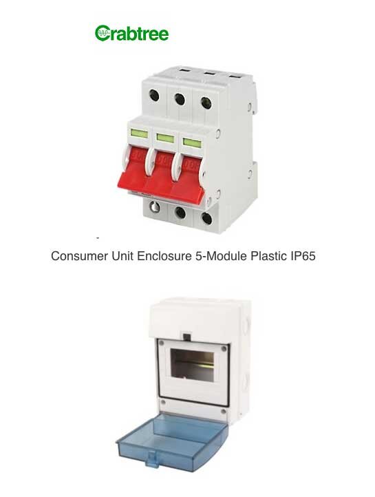

A client is converting his house back into a house with one domestic C.U. Previously this was divided into flats from a 3 phase header. Each flat has it’s own meter (4 in all).
I suggested he get the distributer to remove the extra meters and cap 2 of the phases.
He said he would like to keep the 3 phase as his wife has a 3 phase kiln and would like to use this in the garage.
I am thinking of placing a 3 phase incomer down stream of the meters and supplying the house C.U. from one phase and the kiln from a triple pole CB from the same incomer (via connection block if necessary).
I would also put an isolator at the garage end in an enclosure, see pic.
Would this be an acceptable solution?
3Phase_incomer.jpg:tt1:
If you have 3 phase, use it and keep it balanced!!
Tpn board, with rcbos for the necessary ccts??
Get rid of the 4 x 1ph meters and get a single 3ph meter in.
The customer will get 4 bills otherwise.

I am not exactly a 5.W.W. but I did leave the industry for a number of years and re-trained as Part P 2 years ago. Most domestic jobs are single phase but I know how to deal with 3 phases when I come across it. I do not know everything though and new materials and practices are happening all the time.
Most of this job will concern the distributer taking out the meters and installing a 3 phase isolator.
The rest is going to be the installation of a 17th edition single phase board for the house and running a multi-core armoured cable to the garage for the kiln.
There will of course be load factors to be taken into account.
Yes, I think this sounds like a sensible option. The Incomer and board is going to be moved to a new location (about 2m away from where it is now)
