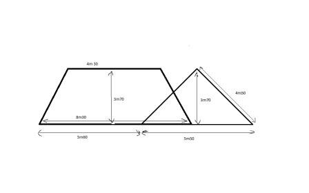

im playing with pvsol and can only get 9 x Sanyo HIT-N235SE10 panels on this woman's roof, i also noticed that Segen are saying Fronius inverters now come with a 20yrs warrentee which she loved, trouble is pvsol says i cant get a Fronius inverter for that configuration.

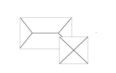

you mean the inverter is chosen on your location, why des this make a difference??, also SolarMax isnt on my inverter selection in PVSOL, its drawing the roof in 3d im finding a Problem i cant seem to adjust the roof its the worst drawing software in history, but i know once im shown ill get the hang of it
