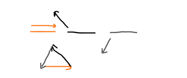

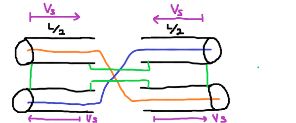

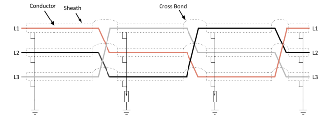

By way of a teach-in, the scheme Lucien mentioned to cancel out the induced voltage in the armouring is often called 'bonding and transposition' which is especially important on long, high voltage, high current single conductor armoured cable.
For the single phase case the idea is as shown in my first attachment. The sum of the induced voltages in the four equal length section is nigh on zero - clever eh.
For three phase power transfer along three single conductor armoured cables the scheme looks like the second image. This time the induced voltages along each 'horizontal' level is arranged by the transposition of conductors between equal length section to sum to zero - the classic delta sum of equal magnitude phasors displaced in phase by 120 degrees. The two boxes with a single arrow inside are SVL - Sheath Voltage Limiters - see:
