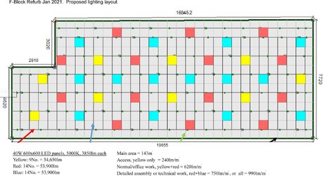

I'm using this tedious 'holiday' to fit a new suspended grid ceiling in my large open workshop.
Here's the provisional lighting plan, using drop-in 600 square LED panels from TLC. I have three existing circuits available (currently feeding 5 x 400W metal halides, which will be disconnected.)
Depending on the work in progress, I'd like a selection of lux levels, without the trouble and expense of using dimmable panels. So I'm fitting three separate circuits. Sketch and specs below.
Have I missed anything please? Has anyone done it like this before? (I'm new to LED panels).
Any comments/ideas before I build the thing?
Cheers, Mark
ps. (Of course the psychedelic colours are only to make the individual circuits easy to visualise. All panels are 5000K :cool: )

In principle it looks and sounds fine. Depending on what work is being done in there. For instance if colour is important you might want to consider higher CRI factor. It sounds like you will be doing officey things in there? If so you need to get lights which have a UGR of 19. You need to know in advance the lumens deliver to desks, assuming there will be desks from your descriptions. The one big factor you need to work out is what is the inrush current. That amount of lights will struggle not to blow the MCB due to inrush. You might need to split them up circuit wise. You do not seem to mention emergency lighting or anti panic (required in a room that size. Just a few thought for starters. By the way I do a lot of commercial LED retro fit and upgrades. Oh and I don't personally like the asymetric nature of the layout.
my thoughts are that that is a bit of overkill.
my design , numbering the rows 1-13, topto bottom:
stick with row 7 centre line; move row 5 to row 4 and row 9 to row 10; ditch row 3 and row 11:
9 less fittings.
3 circuits, 2 of 9 lights and 1 of 10.
and as vorty says, i'd line them up vertically.
Looking at it again I think you need to come away from the edges of the wall/ceiling. The angle of the spread of the light (120 degrees?) works better away from the wall in delivering lumens/light as it bounces off of the wall better when at least one tile away from the edge. The spacing is right in that there are three tiles apart longwise/widthwise. You might consider if there are any people who have eyesight problems as sometimes I have encountered reactions to lighting in the high K range.
all but one are 1 tile away from walls in his drawing.
True the tiles are one away, the red legend should move two away in line with the others. I don't know if I am reading it right but it looks as if the edge tiles are not full tiles, part tiles by the seeming look of it.
p.s. what height are the ceiling intended to be?
good point.
Thanks for all the ideas. Quick lunchtime reply as I’m working on the building wall cladding today.
Finished ceiling height 3m exactly.
Perimeter tiles north and south are 500 deep, ie nearly full tiles.
Building use mainly mechanical engineering and maintenance by me, but is also rented for office/lab-type research work, with up to 20 people for a couple of weeks. Maybe I should consider warmer lighting?
But I have old eyes and always used intense MH lighting for very detailed work.
I wonder what a mix of warm and cold looks like? To offer a choice at up to about 300+ lm/m2. Naa, too complicated.
The great thing about these drop-in tiles is that I can experiment. But I’d rather do it only once!
I’ll follow the suggestions and draw up some other designs tonight and post. Thanks all for the brilliant help. I'm working alone and miss having second opinions available (even if only to ignore them.) ?

You and Telectrix have caused me to have a rethink. Thanks! Here's a new plan:
I'm slightly concerned that this might not be bright enough. It's theoretically 610 lux with all on, but it is a high ceiling at 3m: the inverse square law is a bugger.
This new design allows for the easy addition of another 13 panels on the red circuit at the red X positions if needed.
I'd originally used so many fittings, together with the weird asymmetric arrangement, so that any one circuit on alone would not be too patchy.
Cheers, Mark.

that looks better to me, but should be more on red circuit, less on yellow and blue. and i would opt for 10A C curve MCBs on all 3.

Because no two jobs/rentals are the same I don't have the luxury of being able to install overall/task/accent lighting in fixed places. So I'm trying to go for two fixed levels (say 'normal' and 'bright') for the whole area.
