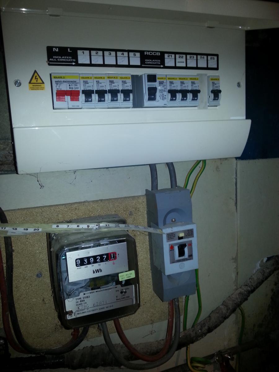

Hi Guys,
Was called to look at this job today, problem with a tripping dishwasher on hi temp, had a look at the C/U and noticed this arrangement, obviously as you can probably see fairly newish board, but still has ELCB wired pre board, and then an rcd within board, my understanding is most people when updating boards usually bin the ELCB and put a 17th edition board in with rcd protection.
I phoned up my Elecsa tech man, and he would just bin the ELCB and put another rcd in the board, I would welcome any opinions on this.

that up front unit looks more like a RCD, probably added to a 3036 board as an update. read what it says on it. it'll be a 30mA or possibly 100mA if the earthing is TT.
My guess is that it was originally installed as an "up-front" device to protect an old fuseboard, then left in as an isolator when the new board was installed. Get the supplier to change it for a simple isolator: Many will do so free of charge.

Hi,
I have the same set up in my house, left it in when I did a board change some years ago. It's a 100mA and acts as an Isolator when I need to work on the board. Has some discrimination with the 30mA on the board.
What for,it already had Rcd protection,maybe to the level it has now,except there is now a chance of confusion when the ---- up between which Rcd goes out is made
If earth leakage reaches a critical stage,its likely its the original that will trip, considering it is covering more circuits,especially if its 30 m/amp rated as well
You could always bin that modern board and fit a Wylex fuse board,then its back where it started,that is, before they were probably convinced into having that existing split board with little if any added benefit

I think when i was talking about ----ing something out in the garbage, i was talking more about the ELCB, as it was probably originally there when an old wylex board was fitted, but my question which has been answered a little bit, is now that a upgraded board has been put it, even though several years ago, you WILL have discrimination between the two ( board rcd and ELCB ), the cost of a another rcd for l/h side is of the board and is minimal, will omit this discrimination would it not, and bring the board upto 17th reg standard without any dicrimination problems in future.
No, you won't! Only if one of them is a S type (time delayed) will you achieve discrimination. The fact that one is a 30mA and the other is a 100mA makes diddly squat of difference to an earth fault of 700A.

and there's room in that CU to fit a RCD to the left hand side, with a bit of re-jigging.

Has to be an s-type 100mA unit if you want discrimination.
This is why I said the new board that was installed was a waste of space,a useless amount of money spent,all in the name of someone who shouldn't be installing/just interested in making money on the back of incompetence
If it is seen that upgrading is required,then either improvement for the benefit of the customer should be the focus, or the amount of money that can be gained by dealing that customer bullcrap has to be the priority
Do the job right,alter the garbage that was installed and replace the original stand alone RCD with an isolator

Agree Guitarist, as I said in my post it's not that good a discriminator; but when I fitted the board ( 16th edition ) it did give me some good overall protection on the non-RCD ways.
