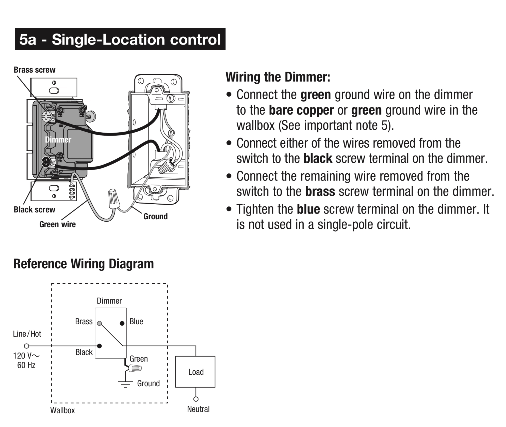

Hi, my wife and I need to replace a single switch dimmer that is not LED compatible. Our local hardware store told her that the Maestro Companion dimmer would work fine in a single switch installation, and sold it to her even after she pointed out that the box says it can’t be used alone. They were insistent that it would work fine. But I can’t find any information online saying this is safe, commonly done, etc. I also can’t find any explanation for why it won’t work if I do. It looks to me like I could just hook up the ground wire to the ground, and the power wires to the black and brass screws. Is this an obviously bad idea?

dave955 - what is the model of the dimmer you have bought? It may be that it can't be used, for example, where you have two switches/ dimers controlling the same light.

It’s the MA-R here: Lutron Support Center - https://www.lutron.com/en-US/pages/SupportCenter/support.aspx?modelNumber=MA-R&Section=Documents
I don't know what it says on the box, but in the instructions it says the Maestro Accessory Dimmer MSC-AD cannot be used on its own, but that's not the one you have!
The installation instructions show how to wire the MA-R as a single dimmer here:
So as far as I can see you are OK to use it 😀
