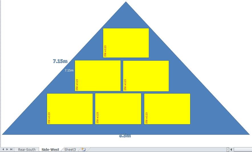

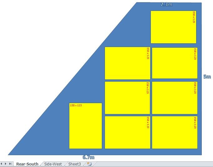

Hi Guys,
Here are the rough dimensions of my rear south facing roof and side west facing roof and my very basic design done in excel!
thanks,
Rajeev
Hi Rajeev
You can't mix landscape and portrait in the same string, they have to be same orintation, same panel, same azimuth and same pitch, so your down to 7 and 6
There should be at least 400 mm from any edge. (ridge / eaves etc)
Is the 7.15 m on the drawing the 'slope length' or the distance from the apex to thebase of the triangle? The other dimensions are clear enough.
Anyway, you'ld get 8 x 190W generics in Landscape on the Rear-South and 7 x 190W generics in Portrait depending upon the actual dimensions
Even Sanyo's don't yield more becasue of the shape, (and they'll cost a lot)

Hi Worcester,
Thanks for your time in looking into this.
The 7.15m is the slope length.
I will revise my drawings based on your comments.
Why do you think 250W panels won't provide better yield? Are they bigger than 158cm x 123cm?
regards,
Rajeev
