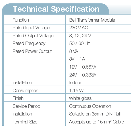

I’ve just looked in my consumer unit and I’ve got space for an extra MCB and a rail transformer for my ring doorbell.
I’m planning on adding a matching mcb however I don’t know if I need a 3A, 6A or 10A version.
The transformer is British General Fortress 8-24V AC 8VA Bell Transformer Module
So I’m working on the basis that 8VA / 24v = 0.33a
However should it be 8VA / 240v 0.03a?
Either way I’m assuming a 1a unit will do the job?
Can anyone offer suggestions please?
Personally I'm not a fan of doorbell transformers inside consumer units.
Most aren't installed with any regard for Band1 / Band2 cable separation, or with any regard for easy maintenance later. I think it's safer to have a fused spur and an external unit so anyone can replace it in future.
But the actual answer is a 3A breaker, if available, will be fine. Someone has commented that this model can put out more than 24V and cause notifications of over-voltage on the app btw.
