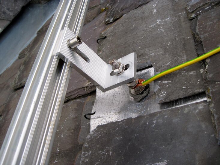

Remove tiles over joist, make lead flashing. Use Schuco hanger bolt SCH-259583 fixed through flashing into joist, sealed with sealing washer on bolt plus leadmate. Re-tile around. Frame attached using right-angled brackets SCH-259665 (called hanger bolt adaptor). You will need to cut the bolt down in length once fitted to prevent fouling and interference with panels, plus to allow access to fixing screw to rail. Picture is on a Scottish Roof which is close boarded and does not use battens to support tiles. Detail would be same on an English roof.
@JulianC, If you are going to do it that is the right way, look very neat. - What size are the unirac bolts and what size was the rafter?

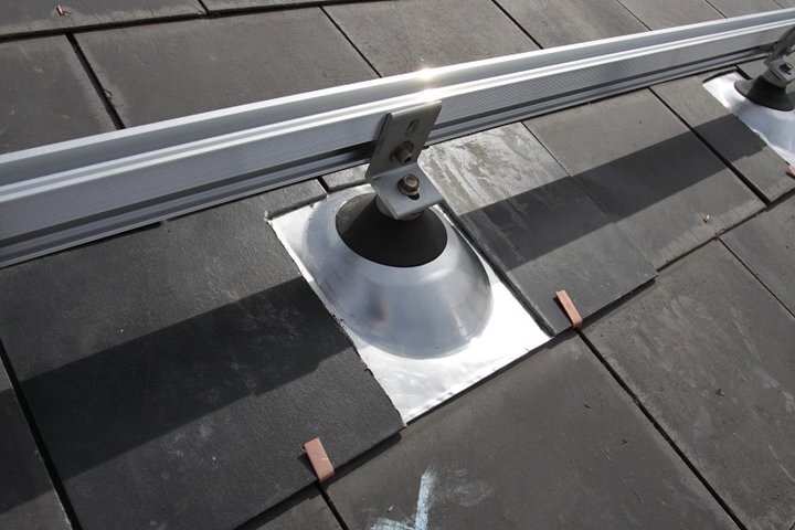

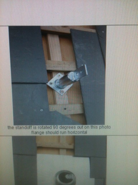

Afternoon all. For the UniRac system, Dulas' part number for the flashing is SSFSM990103 (Unirac's number 990103) - the sheet is 18" x 18" but for the job above we were able to fold the excess under to make it look a bit neater. The stand-off that pokes up through the flashing is part no. SSFSM004400C. The bolts that hold the L-bracket to the top of the stand off are supplied with the kit and are 3/8 UNC x 3/4" (it's a US system!)
The stand-offs have a flanged base with two mounting bolt holes - we use 8 x 80mm Spax screws. Rafters on this particular job were 3x2 and we added some strengthening noggins between rafters on the recommendation of our structural survey.

Looks like one of the other Unirac stand-offs from their range. Same system - screw the post to the rafter and fit the flashing tile over the top. Works a treat.
@JulianC, you can pm me if you like. What is the typical cost of one of those mounting posts, when you take a basic roof hook, add in the lead, and the time of a good lead capable roofer they aren't cheap, so they could be cost effective.
respected member price is £174.74 for unirac 2 piece standoff pack 24
£103.40 pack of 12 flashing
bit costly but if it works then i have no prob (FIT AND FORGET)
@powervan, thanks.
In materials that works out at £16 a mount, if the roof will take 1200mm between supports, that is a similar price to the mounts I use at 600 mm centres (including the lead).

@Gary M. You are right, an eyelet crimp would have been tidier. However the photo was taken for MCS inspection. I raised this point with my assessor and he was happy with this.
@Biggs Solar. Do you have a better way? We are happy with this because it overcomes the issue of drilling through slates. If you use a J Shaped bracket you still have to make that weather proof or mount it on top of a flashing in the same way. you would end up with a much bigger flashing. The spacing is every 800mm also exceeds wind loading according to Schuco data. (the info is all in German but Google translator does a great job). Remember Scottish roof with no battens.
@ Worcester. Yes I am happy this will last. The rest of the lead on the roof is now 22 years old and is in perfect condition. I should know, I built the house and still own it!
@ jerrials. I would go back and re-read the 3rd edition draft. This is what is actually says:
"Tiles or slates removed for fixing a mounting bracket should be re-attached to include a means of mechanical fixing.
Mounting systems on slate or tile roofs that rely on a fixing bolt through the tiles/slates are not recommended. This is due to the potential for damage to the slates/ tiles and the difficulty for ensuring a lasting weather tight seal.
Bolt through fixings systems that incorporate a rubber sealing washer (originally designed for metal roofs) are sometimes suggested as a way of ensuring a lasting weathertight seal on slate or clay tile roofs. However, due to the potential for cracking slates and subsequent worries over long term durability, this method is not considered appropriate in most cases. Only installations on large stone slate roofs, where the slat es are very large, thick and robust – are considered suitable for this method."
They are talking here about fixing through slates. What We have done is to remove the slate and install the flashing to overcome this very problem. It is re-slated around the fixing which is directly into the roof joist. (in this case also through the close boarding).
Sorry for criticising your install, SK. I just hate the idea of drilled holes and hanger bolts. I've not worked on a roof with no battens so I can see it is a difficult one.
